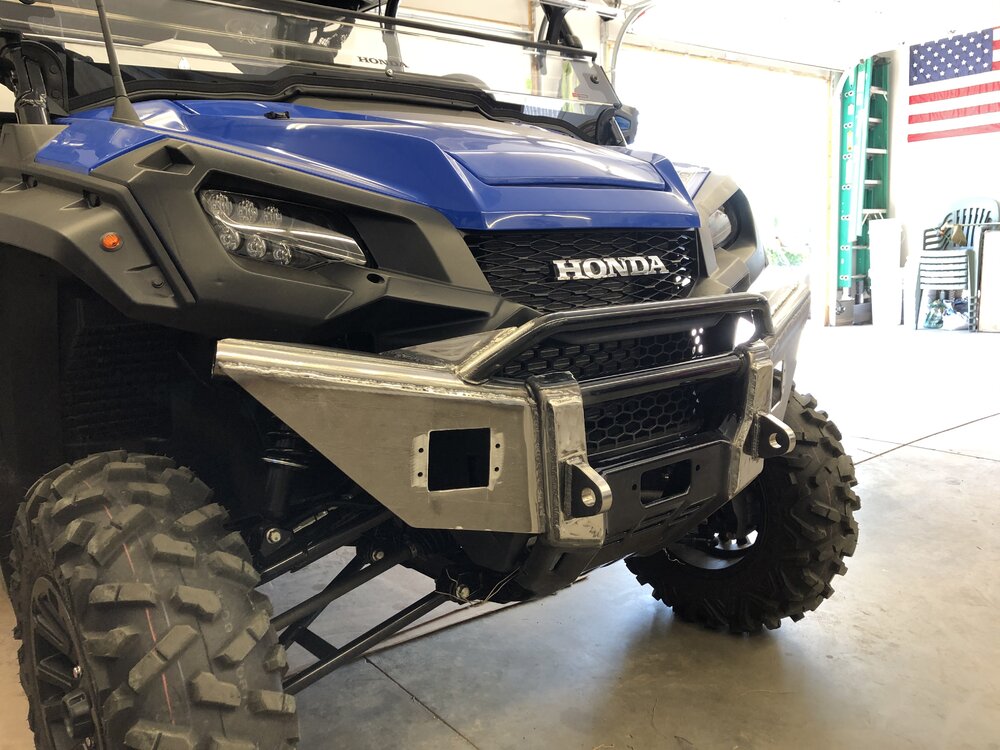

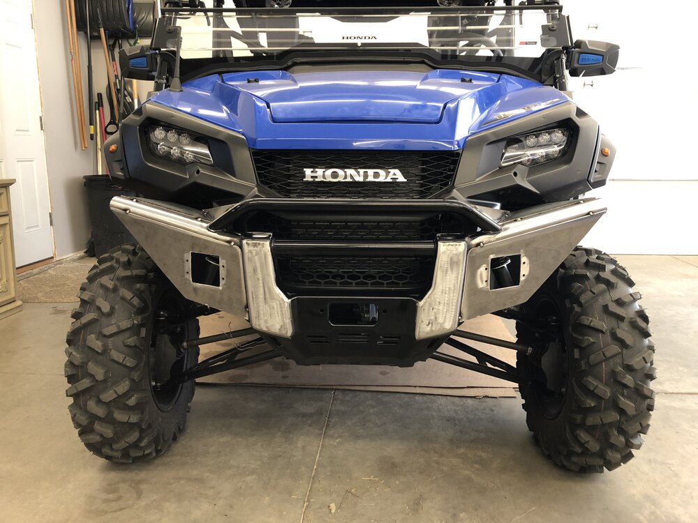

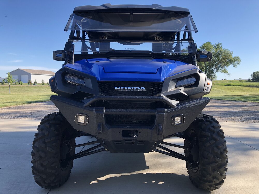

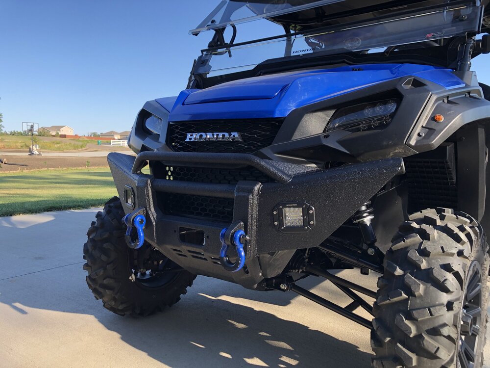

Just recently finished up my factory bumper mods:
Added 1/4" steel front plating, shackle tabs, and tied into main framework of bumper
Added 3/16" steel side "style" plating
Added recessed fog lights
Herculiner coated
And the shackles to matchView attachment 218871View attachment 218872View attachment 218873View attachment 218874View attachment 218875
The factory bumper left me a lot of room to be

The factory bumper left me a lot of room to be desired.
I haven't seen one yet, that I like as good as I do this one. Killer Job!!!👍

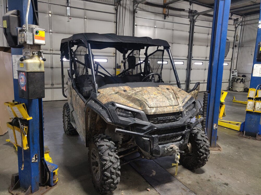

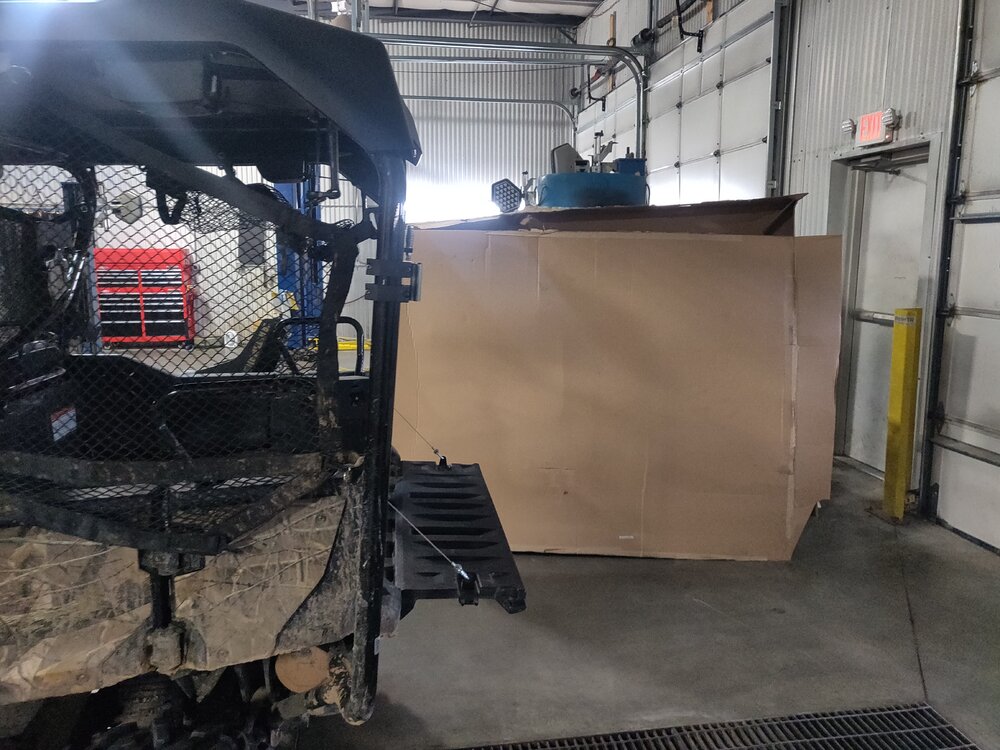

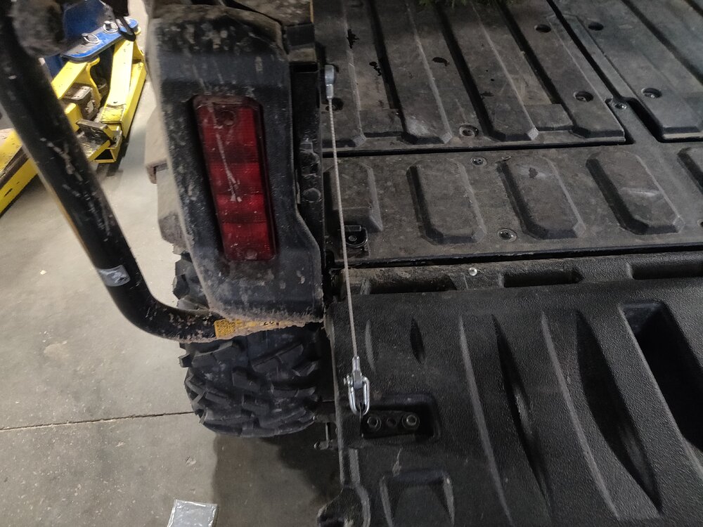

I did the level tail gate mod and installed my Honda oe roof today!
IMG 20200827 183516 IMG 20200827 183520 IMG 20200827 183507

I installed mine as well, that box was huge that roof came in lol.
Sent from my Pixel 3 using Tapatalk
Yes it was. The delivery guy came in a semi not a truck and just left my box in my yard
