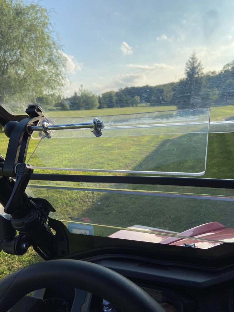

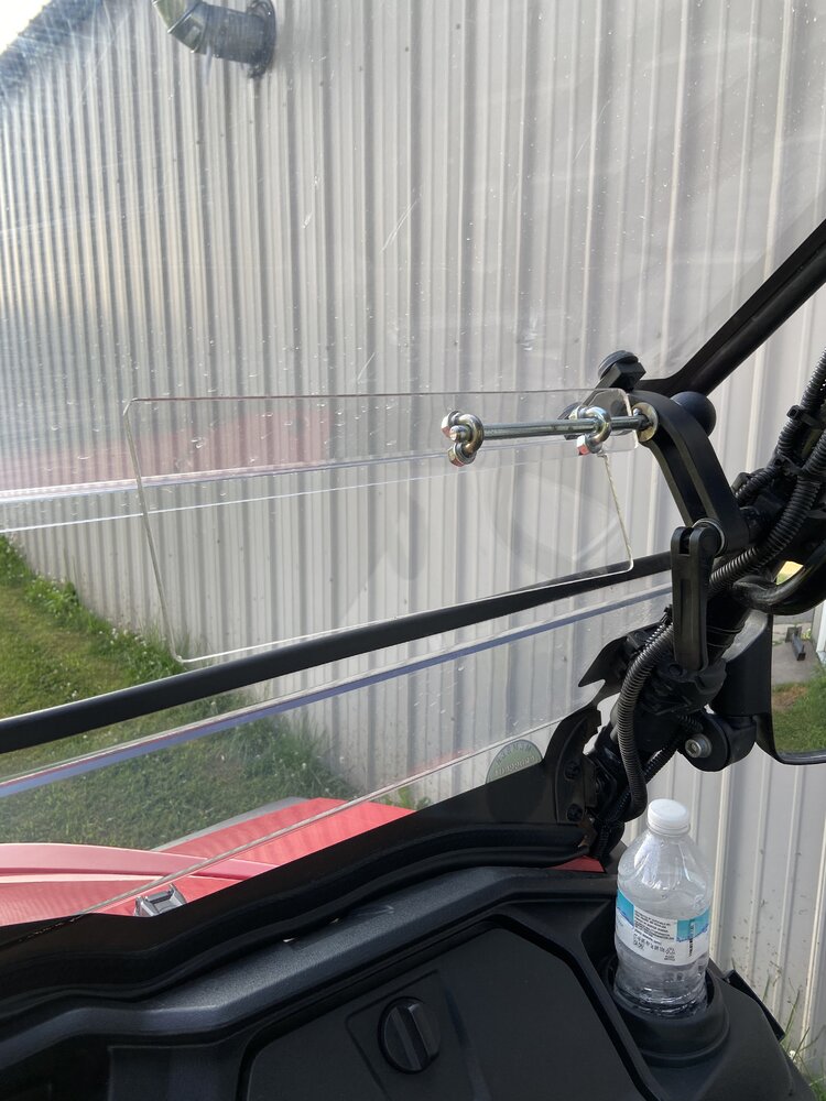

I have the split windshield and still very hot in cab on my 1000-5 deluxe. Made bracket and added bilge blower with 4” hose out the bottom which helps but not when going 35+ mph. Also have the heat resistant material under seat. So I made these today and WOW stay a lot cooler in cab now.

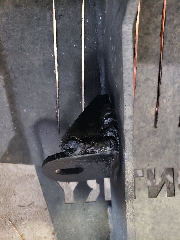

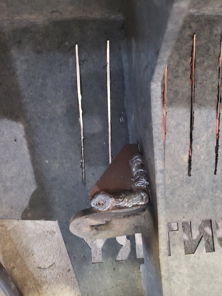

I removed my TC bumper a few weeks ago in order to get to other items I needed to work on. While I had it off I decided to cut some slits into it to help with ventilation for the radiator with Metabo disk, being narrow enough to keep sticks out of radiator (I already posted about that). Before putting bumper back on I remembered what @JTW said about tabs needing bracing. So I cut them out and welded to the bumper tabs and on the P1k5. No ...... the welds are not pretty, but they will do the job.0c2f1a8e36b3d030fe30e80cae205693

I removed my TC bumper a few weeks ago in order to get to other items I needed to work on. While I had it off I decided to cut some slits into it to help with ventilation for the radiator with Metabo disk, being narrow enough to keep sticks out of radiator (I already posted about that). Before putting bumper back on I remembered what @JTW said about tabs needing bracing. So I cut them out and welded to the bumper tabs and on the P1k5. No ...... the welds are not pretty, but they will do the job.View attachment 211664
