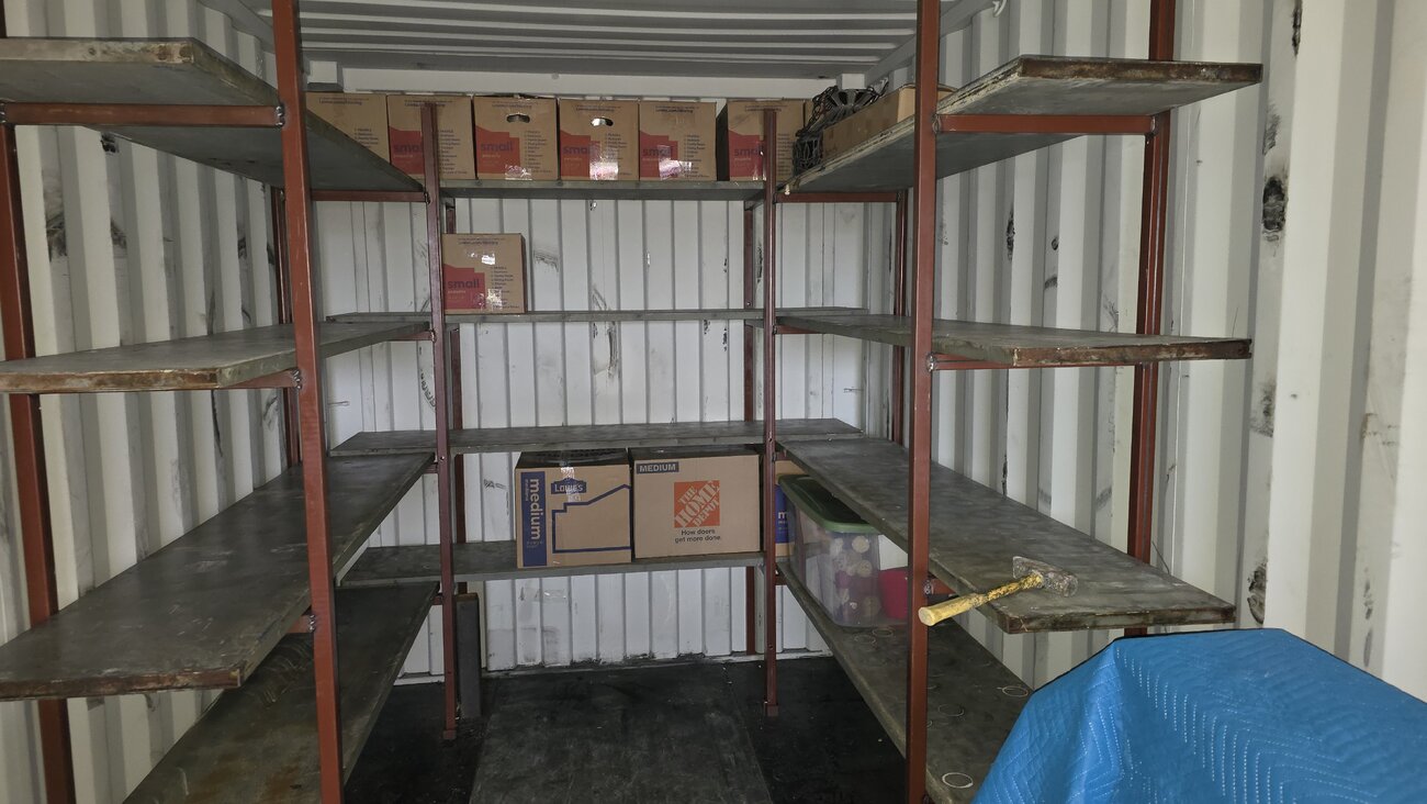

Well got one step completed that I needed to move forward on the makeover for my home shop. Built the shelves in our container, this will allow me to move a bunch of the boss's containers out of my shop.
1-1/2" square tubing and a few leftover elevator doors.

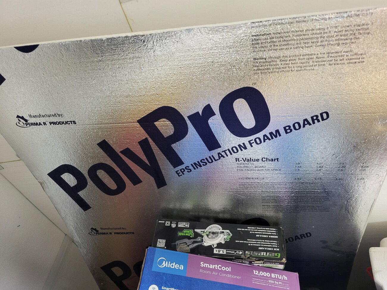

Not sure how spray foam performs over the long run so I used foam board with a radiant barrier from Lowes. The radiant barrier keeps the condensation way down almost none at all. And it was cheaper and easy to put up in a small shop.
Just going through re-reading the comments. @silverado94 , happen to have any photos and or a screen shot of the material you used?

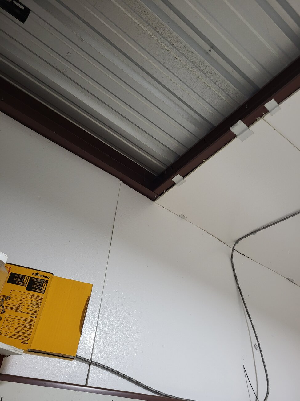

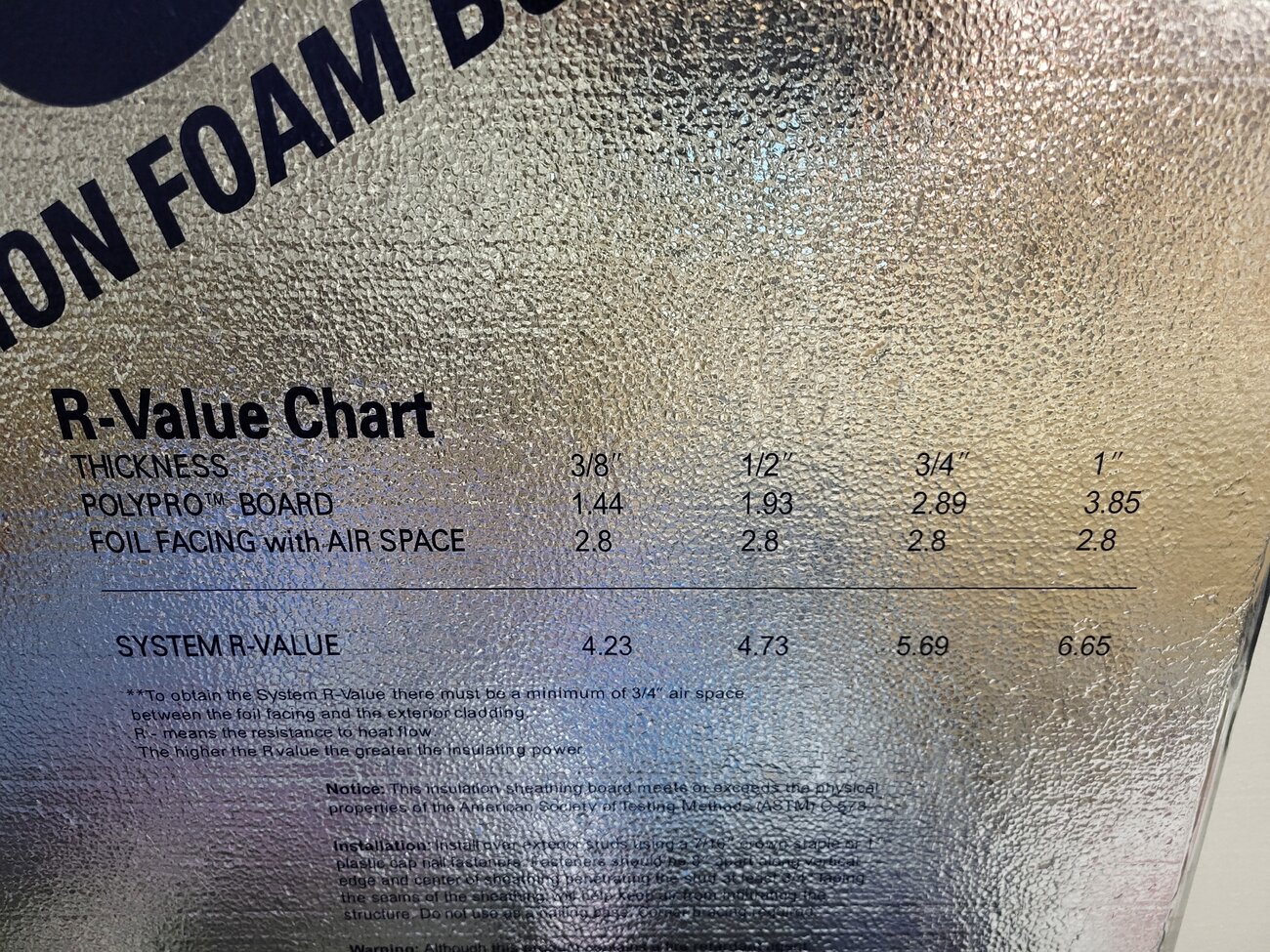

I used this 1/2" poly pro foam board with a Radiant barrier. I got it at Lowes. Can't find it on there website but I did see it a while ago in my local store. Here's a link to a different store.https://sutherlands.com/products/item/3383114/poly-pro-4-foot-x-8-foot-x-12-inch-polypro-foilpoly-closed-cell-eps-insulation-board?origin=serp_auto
I believe my building is made with the same R-panel that you have on your trailer. It says you have to have an air gap with the Radiant facing towards the outside of the building. I glued (liquid nails) little pieces of flat wood to the r-panel and glued the Poly board to that to create the air gap. My ceiling has about a 6" air gap as I put in a wood framework to screw them down to. I also taped the seems (not finished yet) to keep the air in the gap from "touching" the air inside the shop. Which is what keeps it from forming condensation in the shop.
20241209 204519
20241209 204244
20241209 204231
