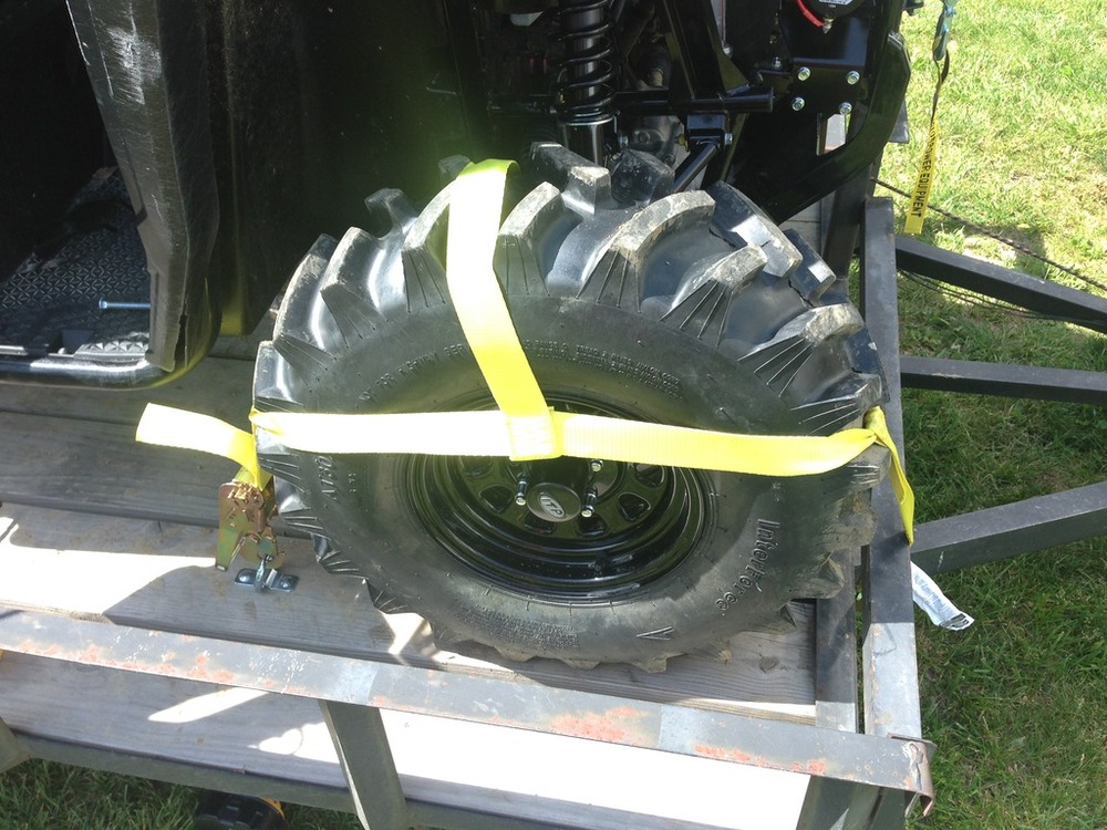

Ya I know Do you like them over straps?? I was just thinking of using the straps to the wheels.
With the bonnets you have to line up exactly in the same spot with straps you won't need to be perfect or when you have different rigs
Put the floor hooks about 3 feet apart front to back and you will have a lot of flexibility in tire diameters etc..

I just run one ratchet strap around the brush guard in front of the front diff. I then tighten the tires against the trailer. Never had a problem so far. I do have a 700 so not sure if the 500 is different.

If you keep putting those hooks in the rim you are going to chip the paint and it will rust. Just a cosmetic thing.

I run one strap across the stock front bumper and one across the rear over a ball hitch in the receiver hole. On a 1400 mile tow (each way) I've had to snug them up one or two clicks. I cinch the machine down pretty good to compress the suspension. Otherwise no real issues doing it that way.
