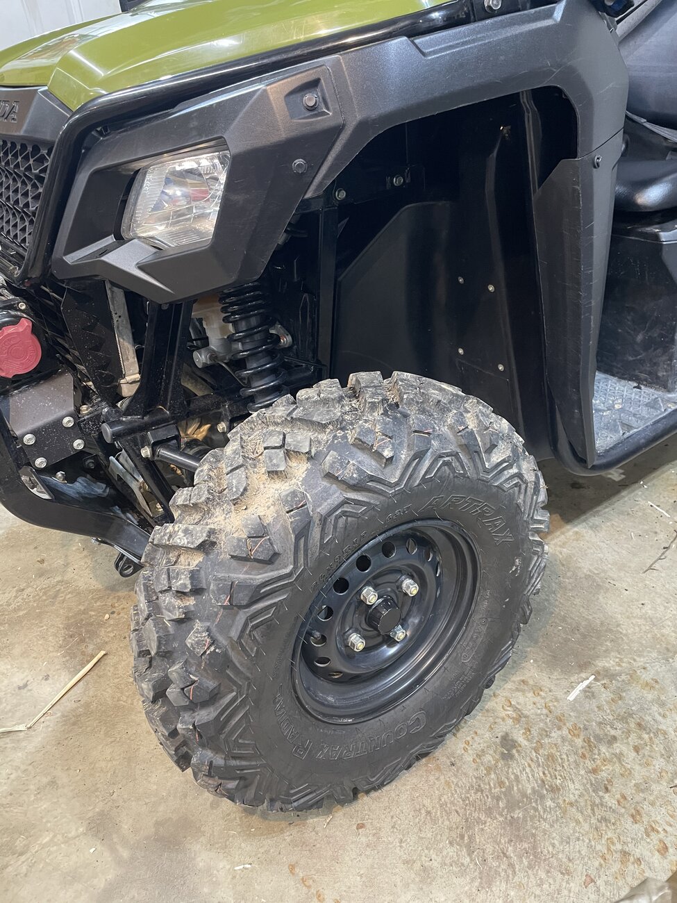

I have 26 11 and 26 9 Artrax radials on stock rims . No rubbing at all. Very stable. Very similar to big horns.View attachment 361954
Very stable? Are you running spacers? Without spacers and 26" tires on stock wheels, it's only stable on flat ground. Many of us are running wide, I'm at 55", and still end up on our side. The P5 isn't that stable of a machine out of the gate so taking it up and not out just makes it worse. There are pages and pages on this subject throughout the forum as well as the stories and pics of guys that thought theirs was stable that way too. 🤷‍♂️
