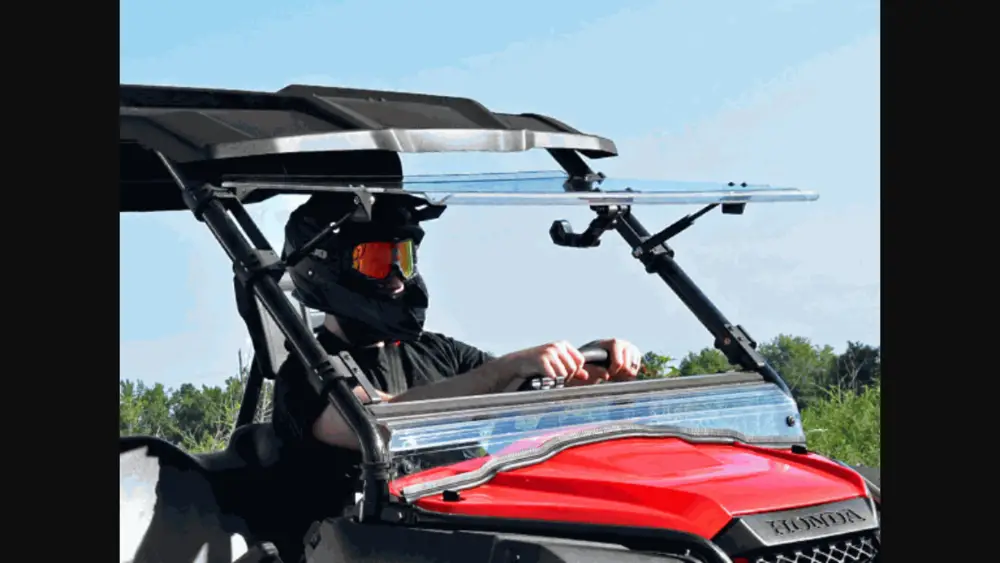

Would any of it work well or be feasible as a replacement for an upper windshield like this??
Possibly. The bottom where its curved would pose a problem. However if it came down far enough, it would probably overlap the lower enough to sort of seal against it. I'd have to see one more close up to be certain. That being said,if the bottom edge being flat can be worked around i see no reason the hardware couldn't be retro fitted to a piece of glass. It would be best if the laminate were set in a rubber gasket though, to accommodate the rough service it would undergo as a ws on a sxs. It doesnt like to slam around, or flex too much. Hence the reason your ws vets chips from rocks, and also cracks from those points easily. Lami is "soft" compared to tempered. But lami stays intact as opposed to tempered exploding when struck just right. Glass is kinda weird in how "strong" and at the same time "fragile" it is.. the plus to the plastics is they are more predictable in how they act for the most part. I could go on, but I'm sure it would bore the hell out of most..
I think the lower bent portion can be gotten around by increasing the gasket size on the lower windshield. I guess my question is more geared towards the hardware mounting and span between it in the raised position. Would glass be stout enough to handle the abuse of riding with the windshield open. I was thinking a tempered laminated glass might be the best option but didn't know what thickness would be needed to support its own weight under riding conditions.
Well, i dont think you can temper lami as its a heat process and it would likely not agree with the lami. I think ideally tempered glass with a film on the back set in a frame would be the toughest. Kinda like the way the armourlite one is.. lami glued in a frame like it is on a car would possibly work too, just depends on how much if flexes. Thats where lami loses its strength. If its "fixed" its very strong, but the edges are weak, and flexing would be the death of it. Tempered can flex more without breaking...right up until you get to its threshold and then its like a bomb going off it explodes so hard. Ask anyone whos had a doorglass or backglass break on them and they can tell you how much energy is released when tempered goes. Like i said, glass is sort of weird in its strengths and weaknesses

Either way, the glass is easy to get cut to size as long as its flat, and you have some sort of frame assembly to put it in you can make it work.

And if you wanted to just cut out the center of the plastic and retain it as the "frame", a piece of lami set in a gasket would be the simplest and probably easiest route. Especially if it ever needed replacing again, then you have an exact pattern in which to replicate over and over as much as needed.
No...
it will shatter
