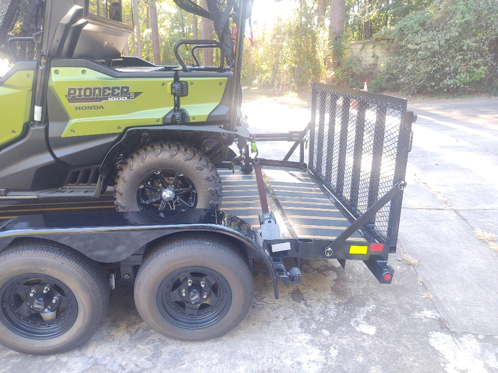

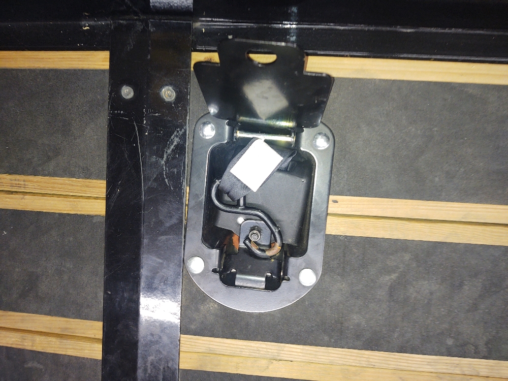

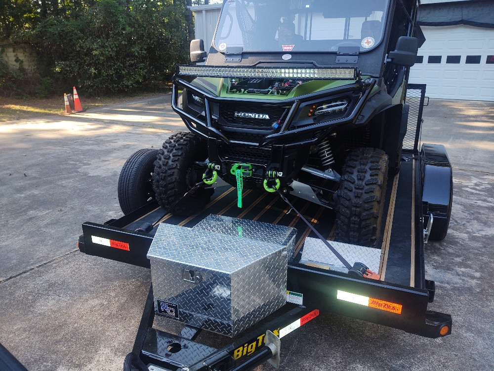

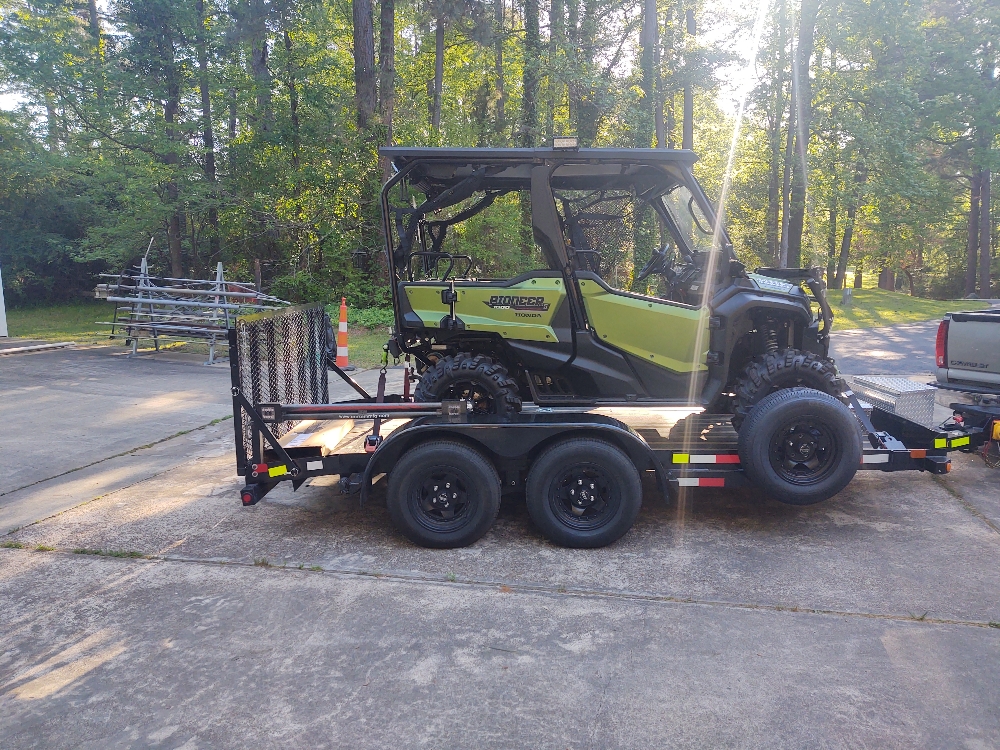

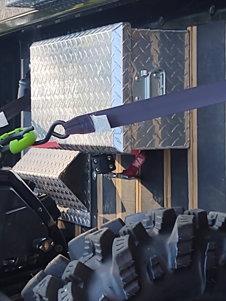

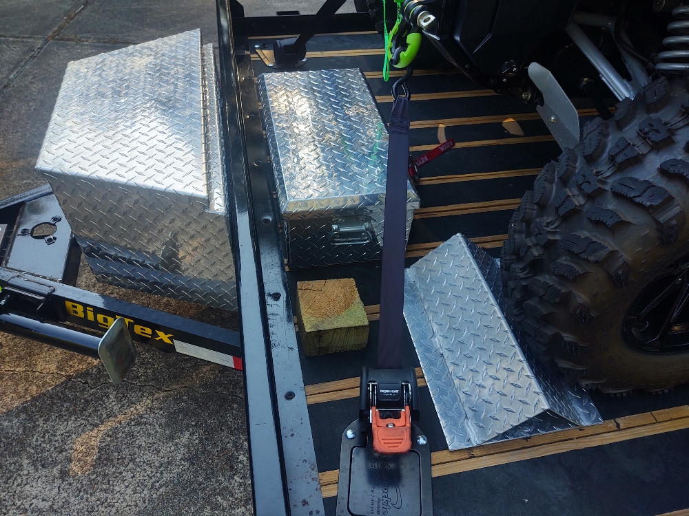

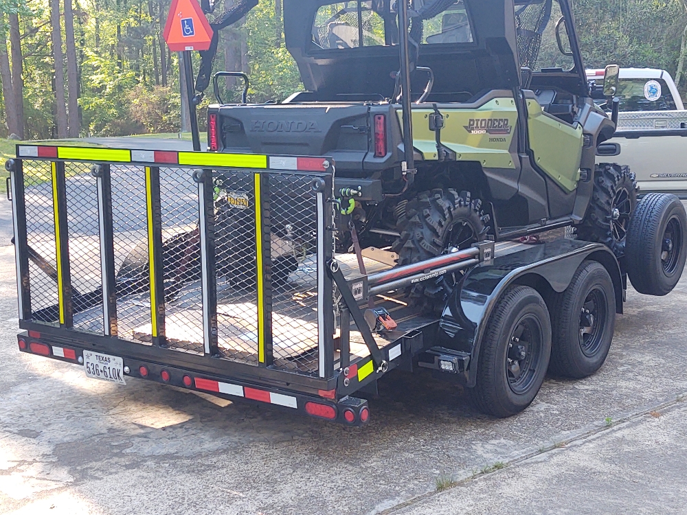

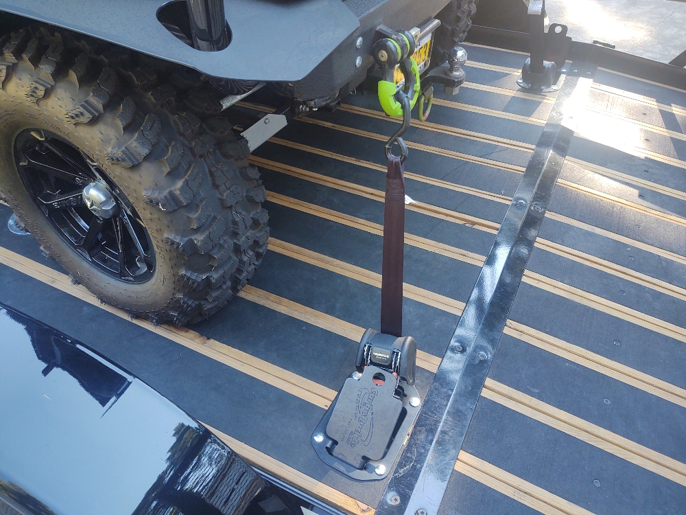

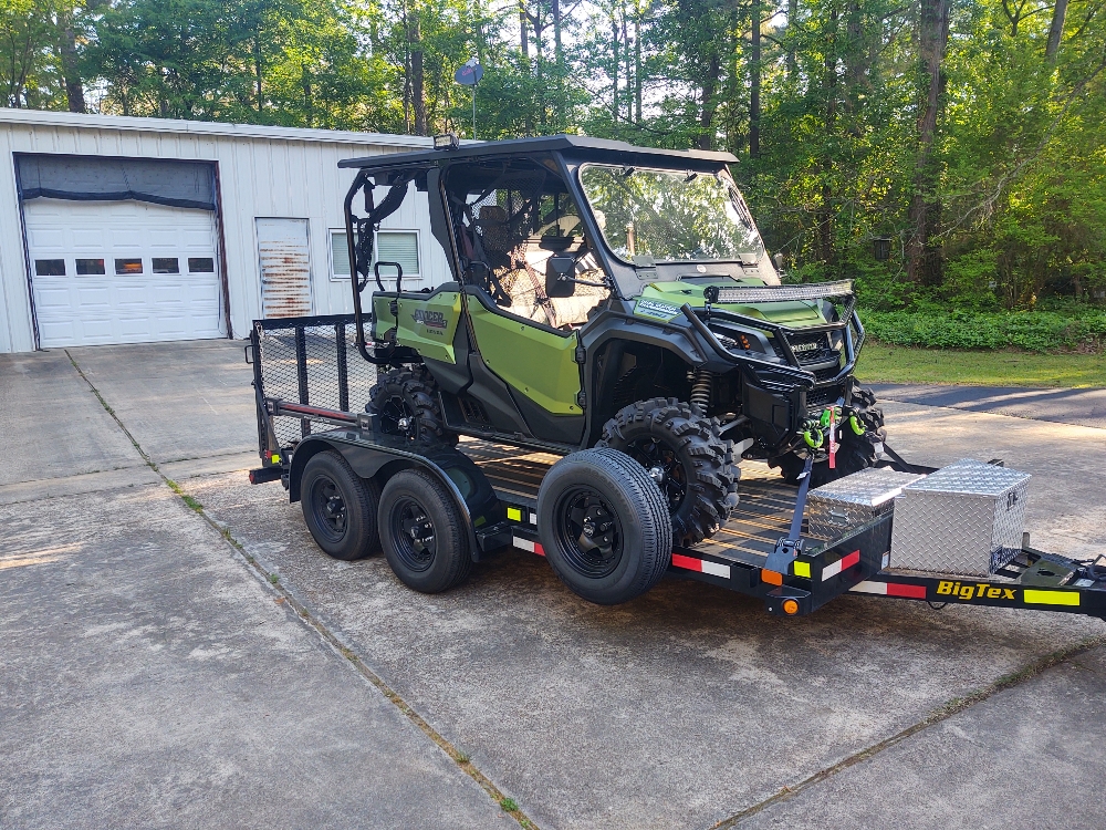

Just an idea. I went with a tandem axle so I could possibly avoid changing a tire on the side of the road and a blowout would mean less chance of losing control. I have a beaver tail so the gate can be smaller. And Blackwood deck that is non slip, even when wet. I have trailer brakes, a Warn 4500 pound winch with wireless remote, fold down aluminum step and a custom detachable handle that fits in the stake pockets to help me climb up and down. The gate is heavy and I have a Double Barrel lift assist that uses a chain drive. It's easy to lift and lower. Sorry if it's too many pics.View attachment 419017View attachment 419018View attachment 419019View attachment 419020View attachment 419021View attachment 419022View attachment 419023View attachment 419024View attachment 419025View attachment 419026

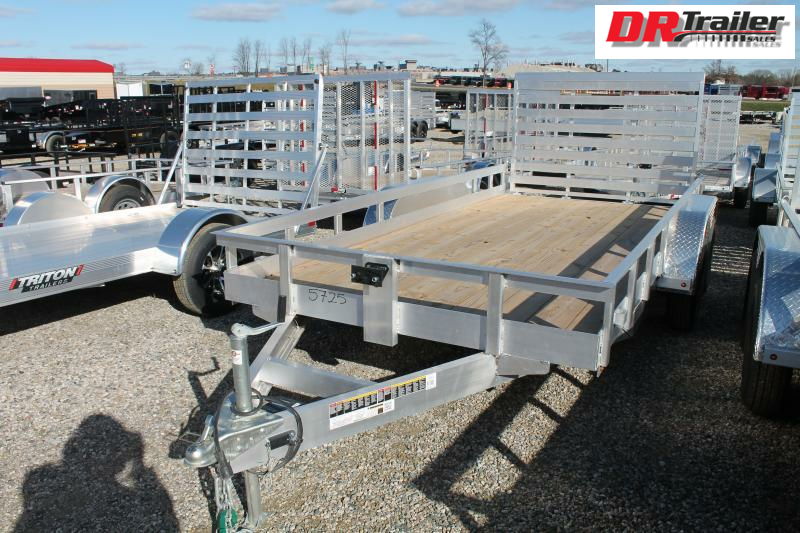

This should fit the bill and within the prices you mentioned, this is a huge dealer in Michigan. 7X14 $4899
STOCK NO: 39916​
MSRP: $6,368.00​
OUR PRICE: $4,899.00​
VIN:4YMBU1421RG005725
Condition:new
Manufacturer:Carry-On
Model:14' 7K ALUMINUM LANDSCAPE UTILITY TRAILER
Color:Aluminum

Yeouch, that's ~$2500 more than I paid for my steel Echo 14' four years ago - pre plandemic. :oops:
