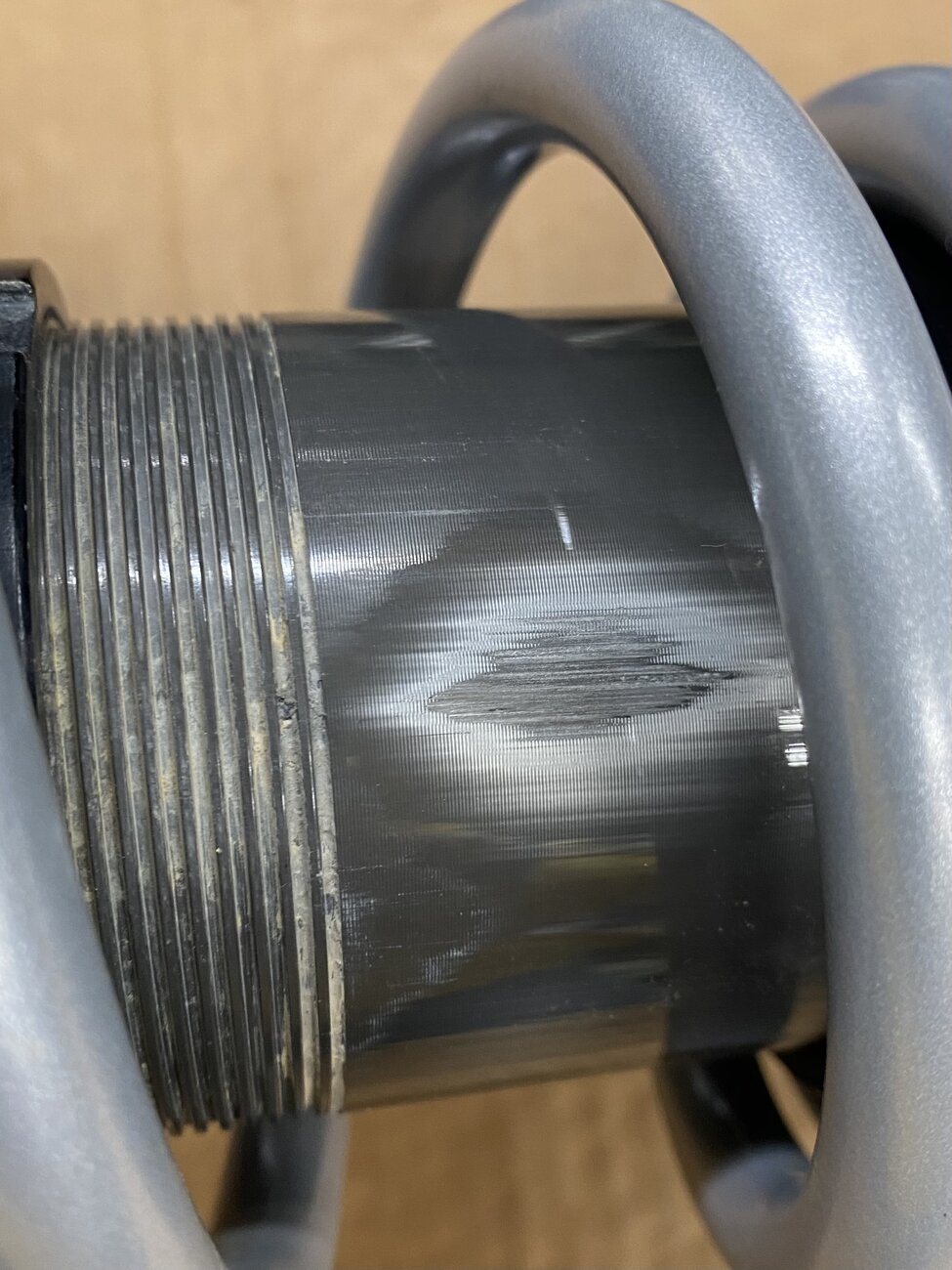

Shock Rub - Is this normal?

I had Elka shocks on a quad and also on a KLX 110 based pitbike and loved those shocks on both. I never had a problem with spring rub on the Elka shocks I've had so it's safe to say they use quality springs.
Another thing to note about coilover springs... The lower the rate and the longer the spring, the more tendency it has to bow no matter what brand it is. A 16" 200lb spring is much more likely to bow under compression than a 10" 150lb spring will. Even the quality springs tend to do that when you deal with spring rates that low. It's something to consider when choosing springs for the front of the machine.
In your experience/opinion best coilover spring brand to buy?
