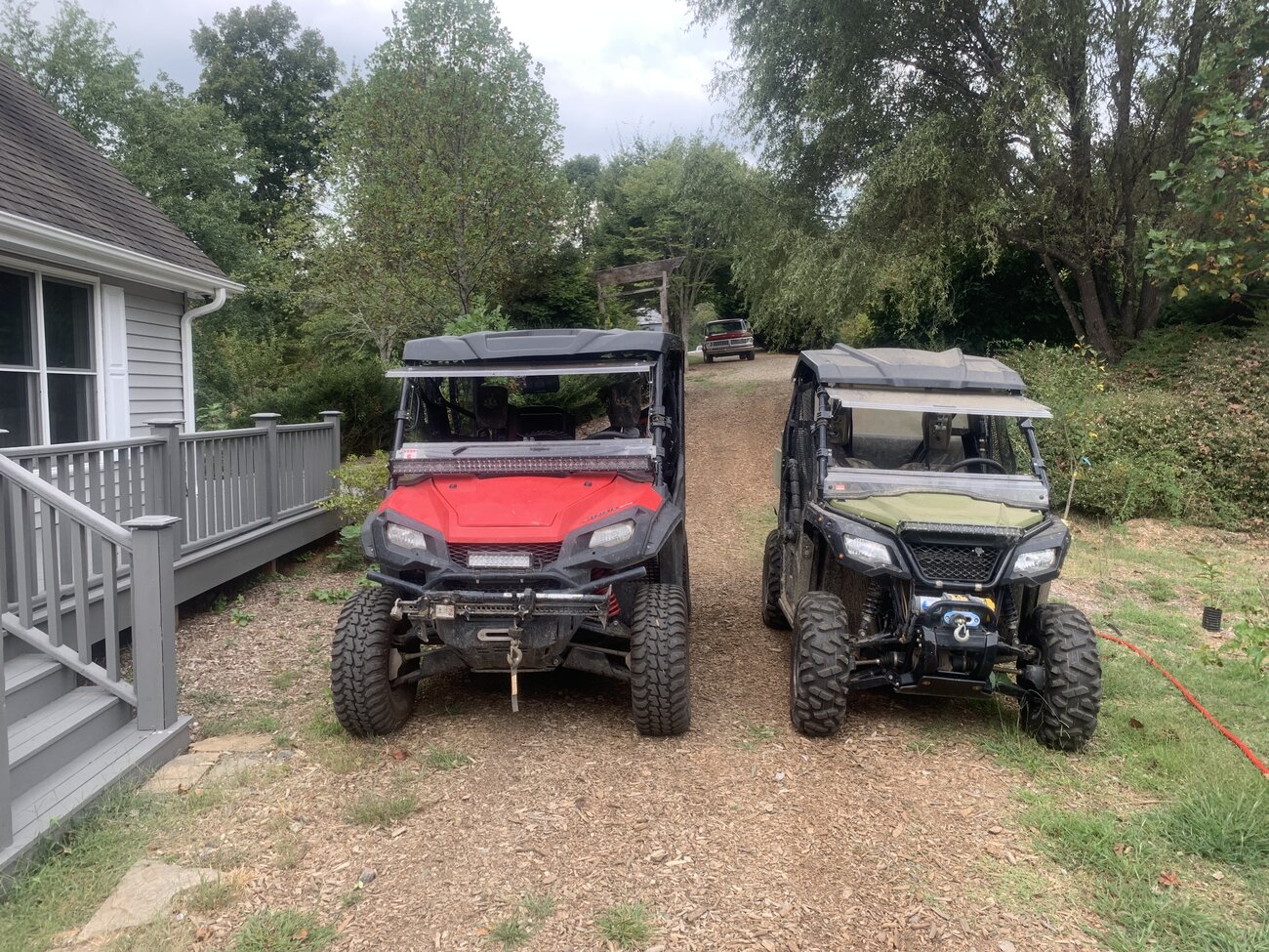

My machines are at 53.5" or so. Pretty sure my compadre @KyGal83 (27s on 5+2 12s) is at 53 . . .

@PSquare ... Exactly This! My driving skills are lacking but The p500/520 is a VERY capable trail machine.
It is well known, I do not like the Tippy feeling either. Recently went thru several changes to try to correct my tippy feeling, successfully.. It feels like a tank now. The tire change was a major factor. Tire size, quality and wheel offset are a very calculated decision for this machine, small changes make a difference.
I would implore you to reconsider selling, especially since you have not really gave it a shot on the trails yet. Give it to the end of the year, come to MOM, meet other P5 owners, see some real world application of the mods. The 500 group and myself will gladly give you any assistance we can..
