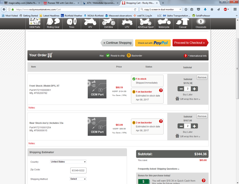

How do I tell the front from the rear? Came off a Commander.

The fronts are stamped 706200782 with the adjustment stop higher up on the body. Looking at the pic it should be the set on the right. The rears are 706000615. Looks like you have a good find there.

One side not is this is only for the shock bodies and bushings. It does not include the springs and retainers, which add up in a hurry if you are wanting to make a brand new set.
