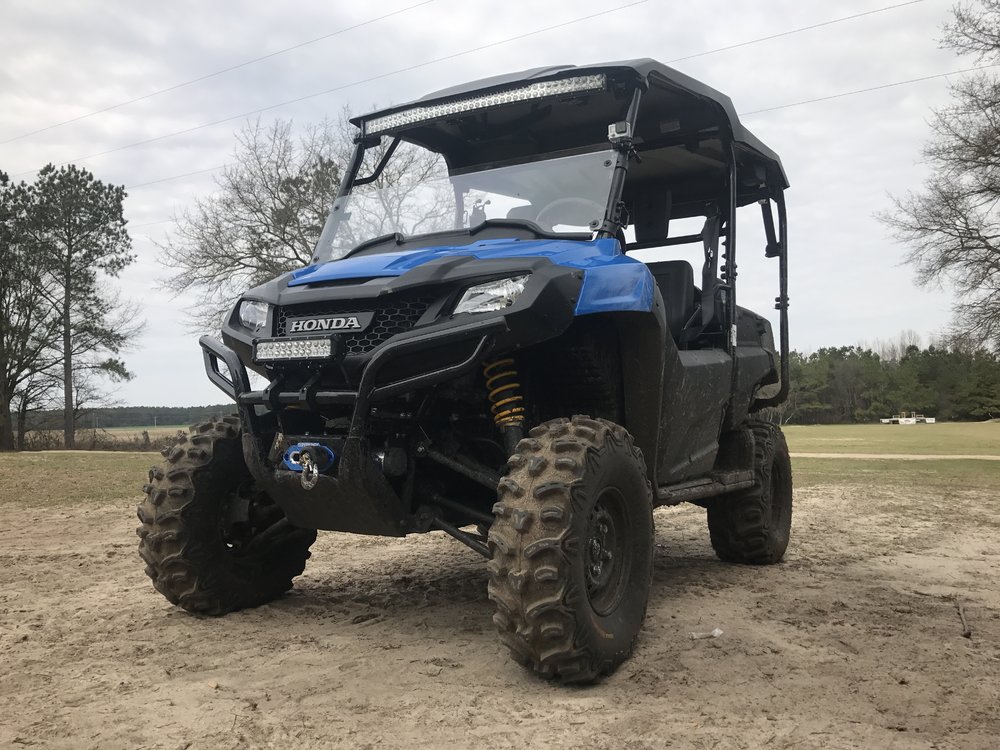

Finally had a good trip to try them out. They were great. Highly recommend doing the upgrade. Keep an eye on ebay.

How are your tires wearing? Comments? Complaints?
very pleased with them... still not my favorites in the looks department, but traction and ride is great. I got a flat this last ride when my valve stem came out. had to ride back on a completely flat tire. to make it worse i had a broken rear axle so i had to stay in 4wd. got the tire reinstalled today and to my surprise no damage noticed as of now. the tires have exceeded my expectations for sure.
