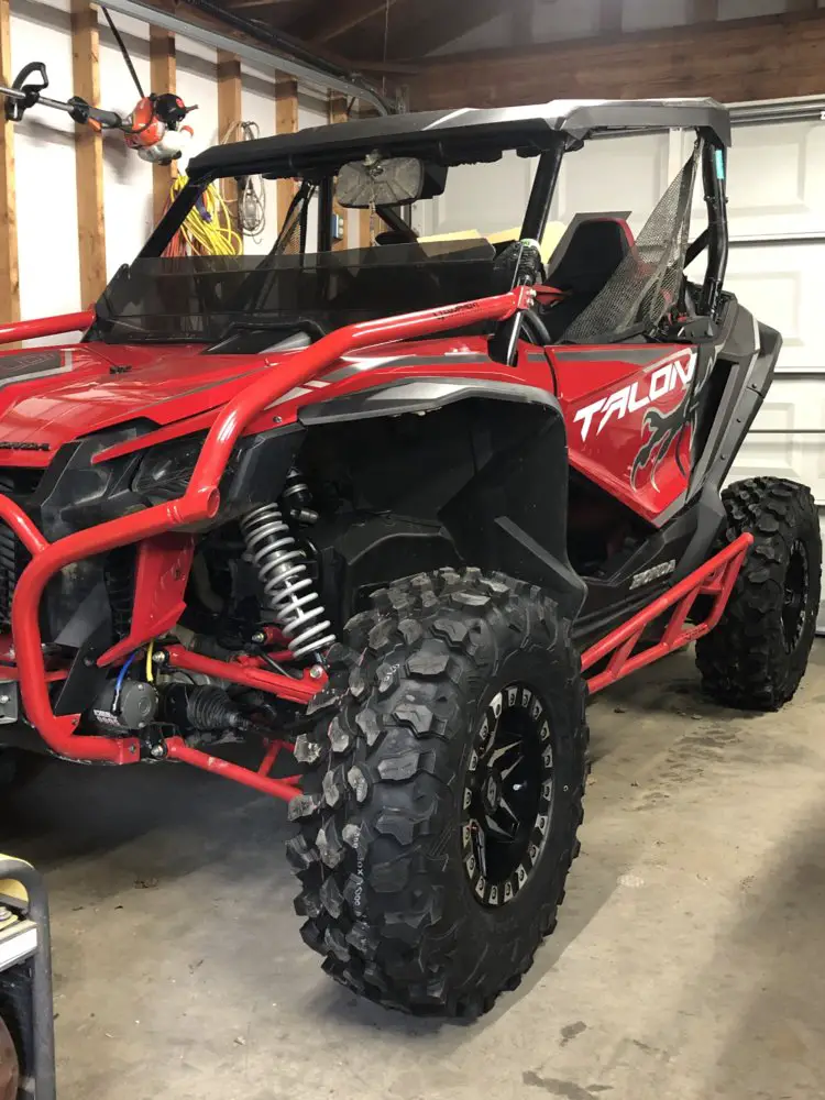

Are those Maxxis carnivores? What size 30-32?

Hey everybody! New to the group here! Here’s my baby so far! Many plans to come yet! I hate to bring up stuff of the past but was wondering if anybody else has had the same issue. So I did my researches from here actually on which wheel spacers I should order to be able to run a 5+2 all the way around and most said 1.5”. So that’s what I ordered in. However when I installed them they were still noticeably narrower in the rear and I even rolled back and forth as well as sat in the bed to make sure my suspension settled. I went ahead and ordered 2” but still don’t think that’s going to be wide enough. Anybody else have this issue?View attachment 199866
