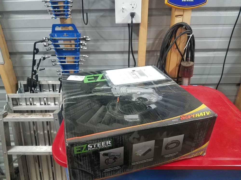

Woo lookie what the brown truck left me!! I feel like I scored big time only spending $350 & NIB at that
1497059074756801237415

Do you have it installed yet?????

You had last night to install it!
Well I did finally get around to installing the EZ steer and you can really tell a big difference with the machine sitting still turning lock to lock. It's a one handed thing now. From start to finish it took me from 11-1, so 2 hour's. Now I can drive n not spill my beer or my Co-Pilot (wife) can actually drive , that means I'll need one in each hand with the cooler full to calm my nerves or to the "hell yea you can do it, hit it hard" stage!!!!! o_O Fathers day cooler needs to be broke in anyway.

$350 ????????
I'm seeing $550. Where can I sign up for $350?
