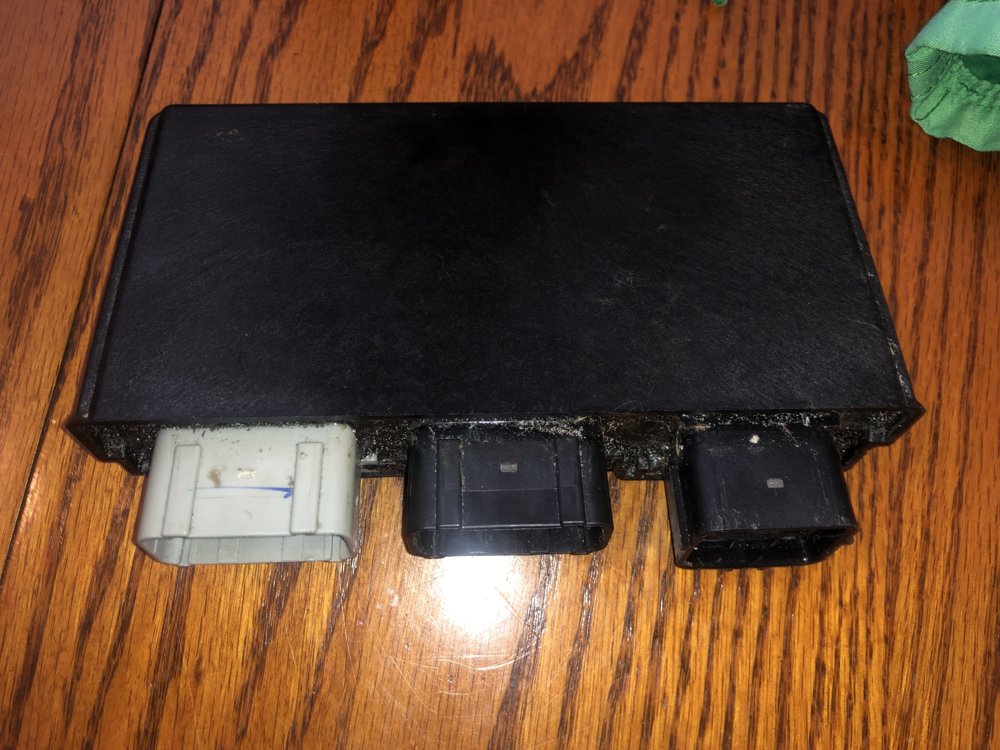

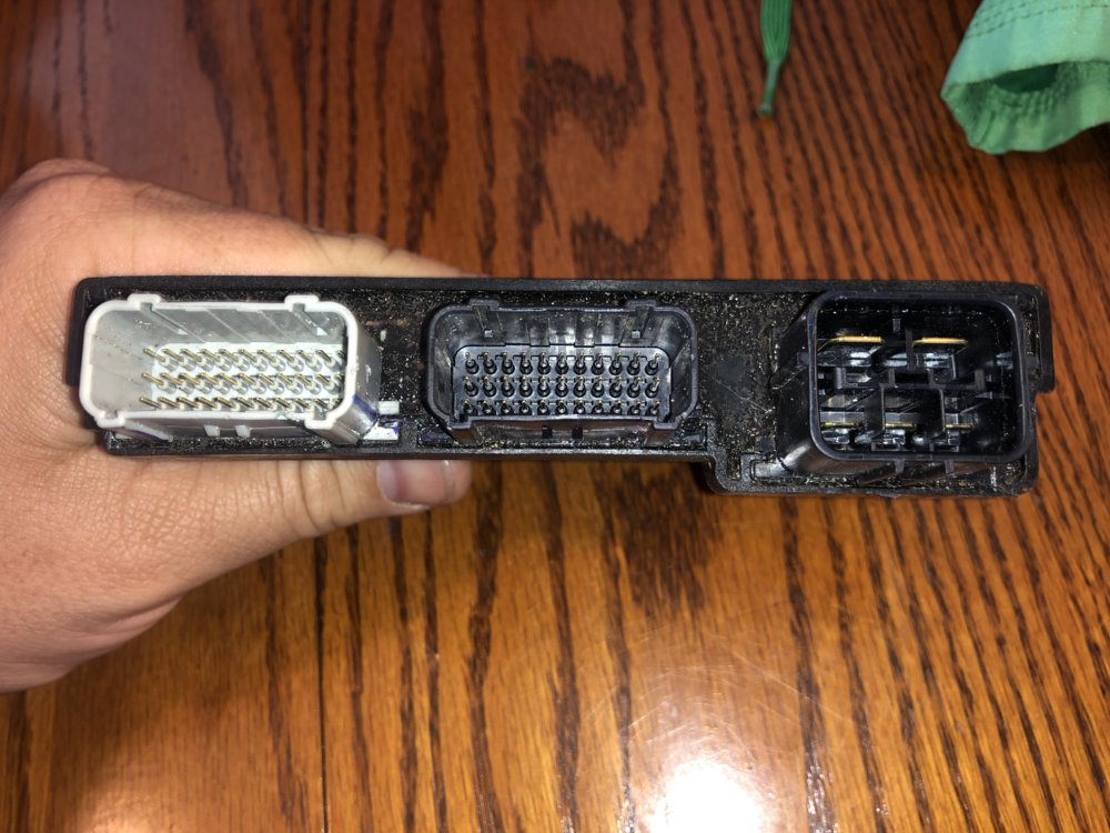

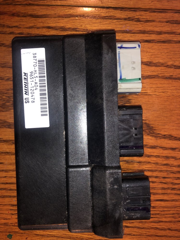

Can you post a pic of the ECM? you might be able to see the PCB for a bad spot.

Correct. Something would have made the ECM go bad.
