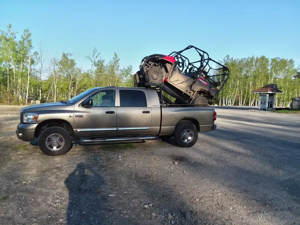

Brother, if you were driving with 1,000 pounds tilted up like that in front of where my wife, daughter or DIL and grandson were on the road/- I’d pray a highway patrol pulled you over and had you pull it off then he impounded/ towed them away safely on a flatbed.
A tire blow- out or have a deer jump in front of you and you swerve- and that setup could kill somebody.
It’s your life and I respect that- but not risking somebody else’s.

Those over cab racks are pretty common here in Canada and meet DOT approval, with machine ratcheted down I’d say they are pretty secure. I agree swerving with a near GVWR load is not a good idea, having tires and gear in great shape when operating any equipment is the way to go.

I think you are making an assumption about how the setup handles. I'm not driving in a POS half ton truck, GVW is over 10k and truck is almost 8k empty. Meaning there is almost 8k lbs UNDER the sxs. A lot of the weight stays below the cab line of the truck. And it does handle quite well.
No different than adding weight with loaded ladder racks or a slide in camper, and adjusting driving techniques. Full height is 11'6" btw.
We just got back from a 800 mile 2 week trip, through some twisty mountain roads through upstate NH and northwestern Maine and I feel even more confident about the setup. So if you see me coming down the road feel free to call the state police.

Did you fab the rack or buy it?
Thinking of getting a house trailer, and this would solve some issues.
My pickup is legal for 2000# in the box or towing 16. Was looking at a toy hauler, but dont want the extra legth.

Run that rig [camper,p-5,ramp,people,camping gear,ect] across a set of scales,I promise that you will be well above your rear axle weight rating.If you are involved in an accident with serious injuries and a savvy lawyer gets involved,you might as well turn your pockets inside out.

I built the rack.
I am most likely over GVW (10,100) with everything loaded, but front axle rating from Chrysler is 5200 and rear is 6200. Empty truck was 7950 lbs, truck is naturally nose heavy but assuming it is balanced that leaves 2,225lbs capacity over the rear and 1,125 over the front axle, total. We pack fairly light, with most of our other crap in the trailer. Trailer has pair of 3500 lb axles and dry weight of 4200 lbs, btw.
I will have to get a scale ticket so everybody can get some rest next trip, or I can find a savvy lawyer to land my load onto.

you might want to have a scale for any law that might ask, if you travel alot seems more than likely. really the dodges have the heaviest trucks and suspension out of any of them, not surprised it does fine. the pickups also had the worst unloaded ride of any of the trucks at work, the only nice riding one we had was the service body that had like 3-4k of steel box and tools on the back and boss steel v plow on the front
