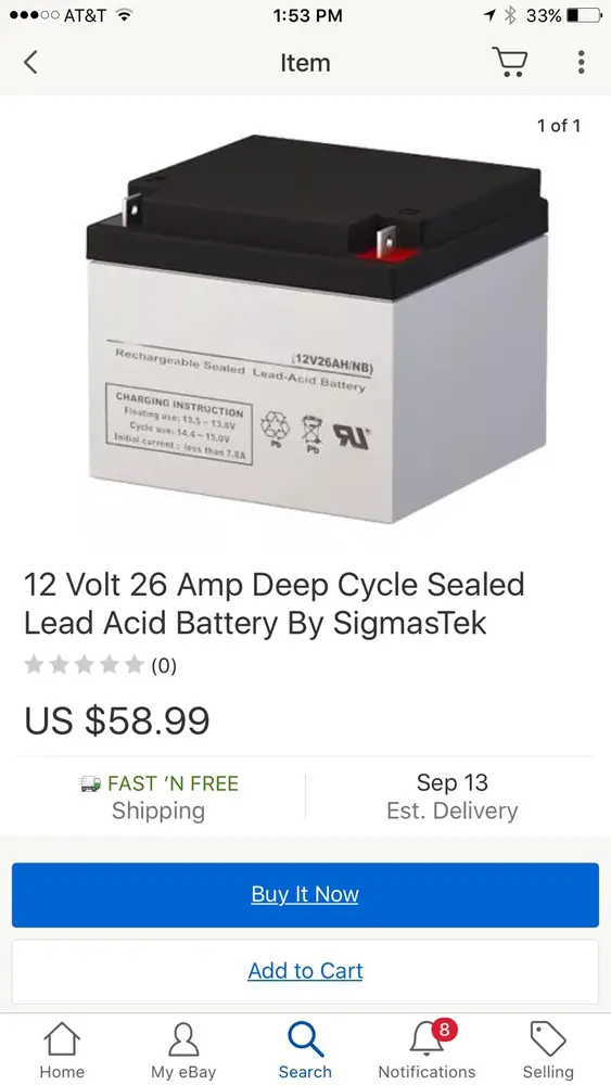

I was looking hard for a picture of it but for some reason I do not have one must not have saved to the phone so I apologize. The battery I was running though was the same 26amp size as the one that sits in the 1000 pictured here. Got lucky it fit the 1000 so well, that was my trick to figuring out batt size so quickly for the 1000 899fe8ed0370691c1668c891325d0bd3
So you can go quite large.

I was looking hard for a picture of it but for some reason I do not have one must not have saved to the phone so I apologize. The battery I was running though was the same 26amp size as the one that sits in the 1000 pictured here. Got lucky it fit the 1000 so well, that was my trick to figuring out batt size so quickly for the 1000View attachment 21757

I'd sure go deep cycle they hold up better but bigger is better especially if you listen to the radio or use accessories while vehicle is off. Mama's ok is always a good thing!!!
I'll look for a pic tonight of that battery installed it's in the site somewhere.

Well thank you for that that's really kind. I can't find a picture for the life of me which sucks because it would have given a little bit of a guide for placement. It sat to the driver side, flat (these are agm deep cycle batteries and can be mounted anyway but upside down) and it's a 26ah unit. Biggest bang for the buck I could find and lasted the whole time we had that rig and a couple months in the new one. We are very hard on batteries so that's saying something. If memory serves me it was just barely under the rear cowl that the hood sits on. I made a very simple bracket with a flat plate and like I do occasionally if the battery doesn't need out for access and used 3m double back to secure it to the plate that doubles as a cushion since it was flat side down. Sounds cheesy but works excellent and looks clean.
