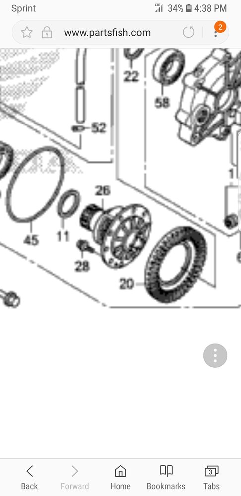

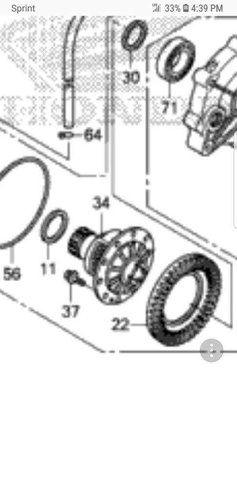

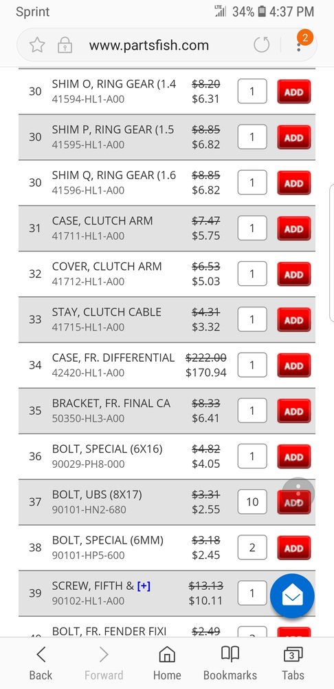

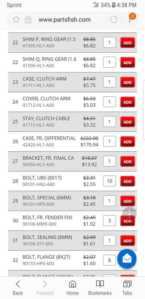

@JWB you got me curious so i headed over to partsfish.com to check out some parts #s on the front differentials of the P5 and P7. Now, keep in mind ive not watched any of the installation videos that you have made yet, so i dont exactly know where the torqlocker installs in the front diff, but if it installs inside of, or replaces, parts #s 26 and 34 in the exploded view, it may very well work in the P700 also. They both have the same part # according to partsfish. Like i said though, ive not watched the video yet to see if this part is even involved. I planned on doing that when my Torqlocker arrives at my house right before i install it lol

After thinking about this for more than a minute.... The carrier for the P7 is the same part #
42420-HL1-A00
as the P500, so the splines entering the side gears in the carrier have to be the same, cuz you can't buy the side gears or any of the carrier's internals separately from Honda . So.... Yes, the TORK-Locker for the P500 will work in the P700. As soon as I get the hardened production replacement for the prototype TORQ-Locker I have installed in mine, I will test fit one of them in the P700 diff I have under the bench, but I am sure, at this point, that it will work.:)
