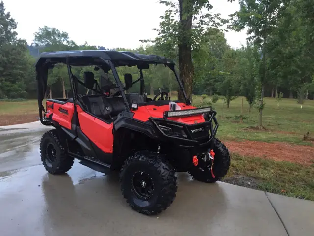

There's only one cleaner you guys need to try. It's called Super Clean by Castrol. I mix it in a pump up sprayer and cut it 1:1 with water. I just spray it on the whole vehicle and then rinse it off.
The pioneer comes out looking like this.....

Wow I find this hard to believe just spray on then rinse. I have got to try it now thanks for the info.

Knock the heavy dirt off first and the spray it on. I'll use it full strength if I spray it on while the pioneer is still wet. If the sun is out and it's hot, I'll mix it 50-50 so it won't be so harsh on dry plastic. I haven't had any ill affects yet. I've been using this stuff for 15 years and it's always been good but I'm care full not to use full strength and then forget to rinse it.
