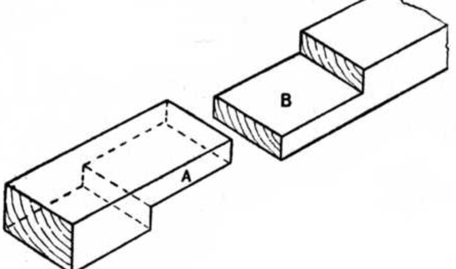

I had been concerned about that as well, but I have a plan for that. I will cut the sheets so they have a half lap scarf joint. That way its flush but the joints are not simply butted together.
Plus a sheet of UHMW that was 5x10 was more than I paid for all the board I bought, and harder to work with by myself. View attachment 31134
Oh and the joints would have the attaching bolts going through the joint.
I routered my joints as well to keep them from snagging

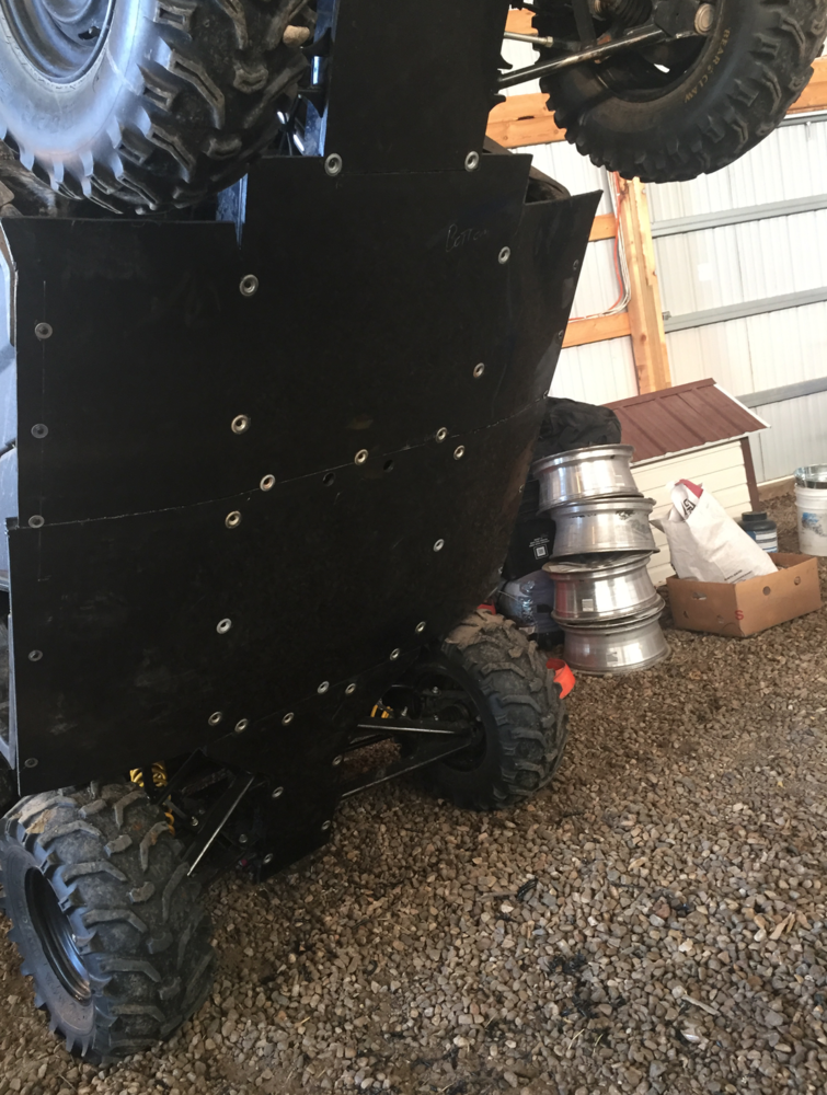

That looks awesome. I would like to think mine is getting close. I had a mishap today, but thankfully the frame holes are semantical so I was able to slightly elongate the holes up 1 size and put it together. My issue was cutting the overlap with my router. Small space and limited light and lets be honest my mistake, I cut the wrong groove. But now you would not know it went wrong. I have more washers coming. There is a UTV/ATV wrecker that has 35 for about $1 each. So when they get here, I will countersink them.
I'm very glad I am. It will make it stronger in my opinion.

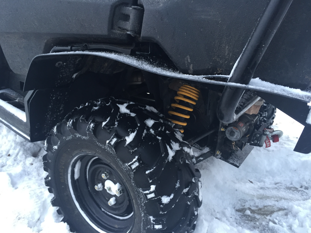

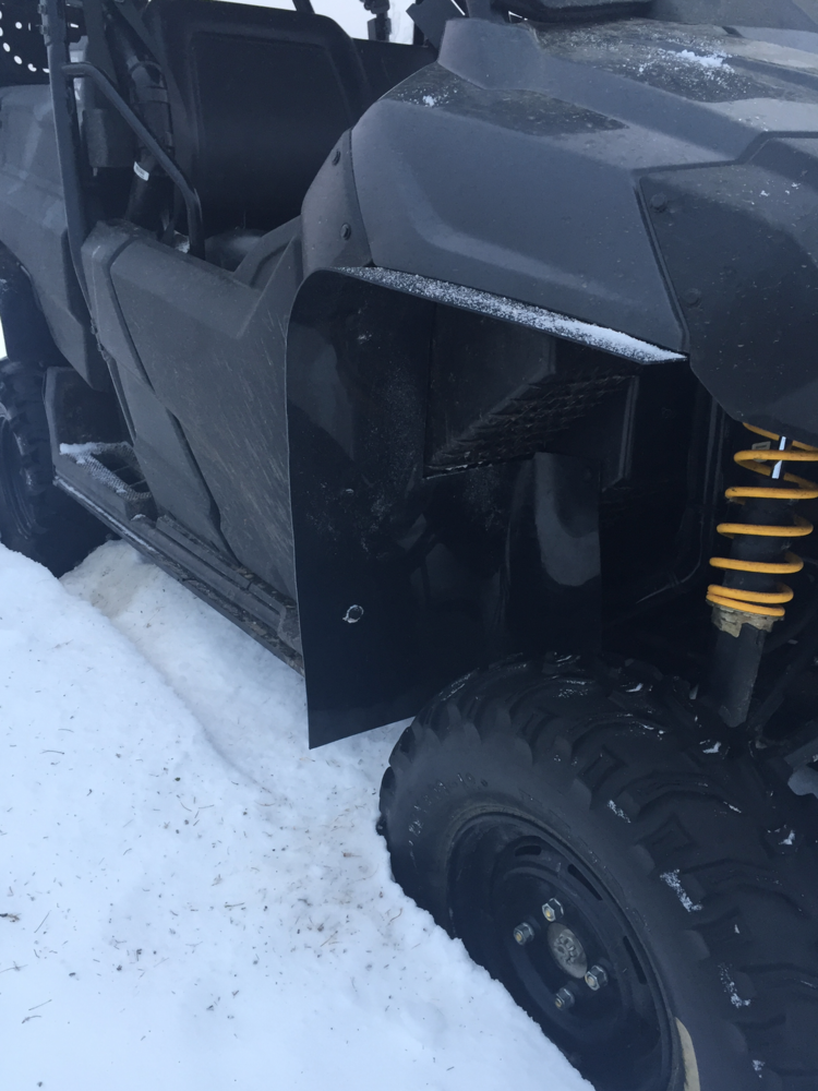

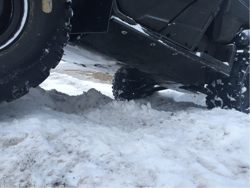

So I got it done. I learned a lot, like heating and bending the 1/2" puck board is not as easy as I thought. That being said, the plan changed a couple times but all in all I am very happy with the outcome. I found some rivet nuts to insert on the outside rails, used all 10.9 M6 bolts and found extra skid plate washers. I then used some 1/8" puck board and made my own flares. Nothing special there, but they work very well and give more coverage than others not to mention a total cost of ~$450 for flares and skid plate.
