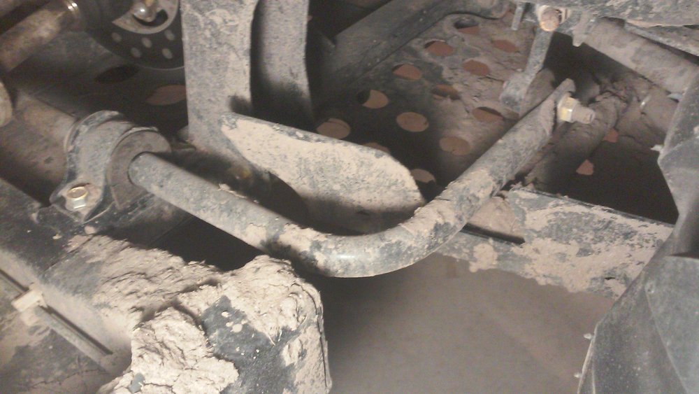

I gave it a good look earlier. I think if/when I do it, I'll go all in and remove it all together. I don't want to leave something unattached under the machine. As for keeping it there for low weight, COG, I'm for eliminating weight anywhere I can.
Remove it completely if you will, but understand that to disengage it you're only removing the rear nuts, it remains connected at two points in the front, but no longer functions. I've never removed mine, but those who have say it's a bit tricky getting it out. I recommend that you leave it in place for a few test drives and satisfy yourself that it's an improvement for your driving style. If not, it's a few moments to reconnect.

After I got it out, I was standing there holding it, thinking, "Maybe I shoulda zip tied it". Lol.
Lol, you make a good point J, that would be me too. So by taking off those two nuts, it's no longer functioning? Looks like they're hooked above there too and to two bushings on the frame.

Went back and looked at my own pic, so you're zip tying it up? Loosely? Won't it bang around under there?
I don't know about the 500 but it was fine without zips even on mine just turn the two ends that connect it out of the way for clearance. I'd suggest like many others to unbolt it and feel it out before you pull it it's just so easy. I'm also a big fan of it out finally pulled mine fully out tonight though and not going back in! Not for everyone but I think most especially people that aren't just cruising roads
Be careful till you get use to it side hills with uneven ground it'll occasionally leave skid in your shorts and high speed hard maneuvers should be avoided but 90% of the time better. Feel it out
I zip tied mine but they eventually broke, no rattles though, it's pretty snug where the front bushing connectors are.
