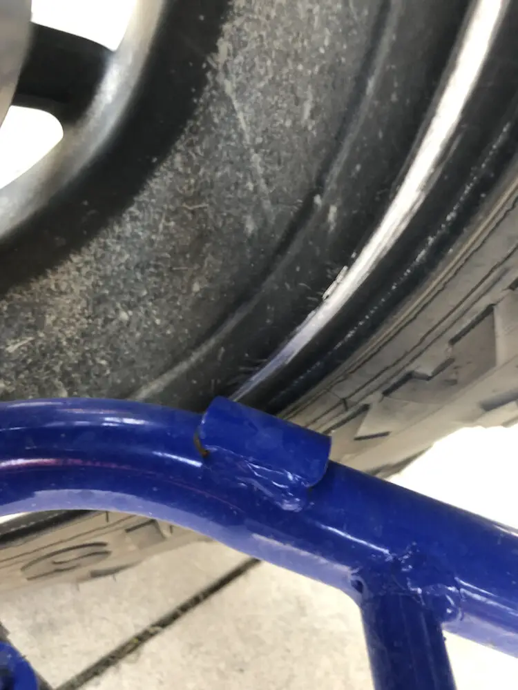

So the right stock Rim is rubbing on the little tab that is welded on the a arm. Anyone know why. The left side clears just fine and doesn't even get close. Just a heads up, I have no idea what I am looking at so if I get some terminology wrong I apologize and am totally up for learning! TIA

Is your tie rod bent?
35,445
208,726
Not that I can tell. Is the tie rod what makes the wheels turn and connects to the steering box?

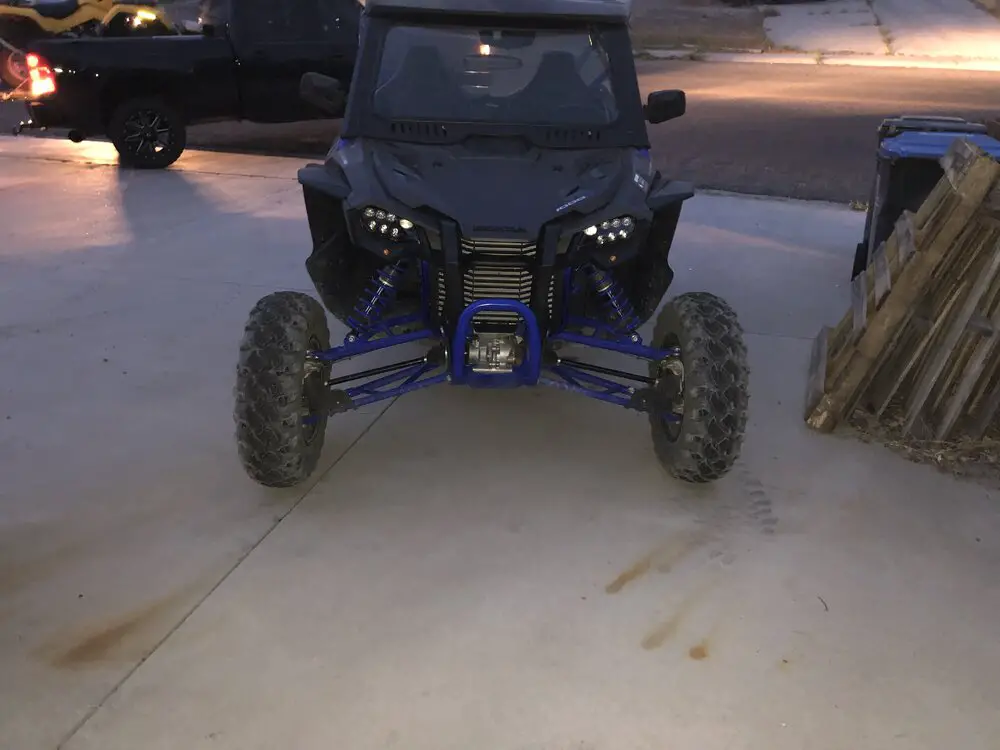

Yes, Is the alignment off? Take a frontal picture and post please.

Also measured from the center of the front of the tires across and the back and they are equal distances.
Pictures are deceiving from my end, but looks like the right side tire is scrubbing on the inside of the tread. Just because the centers measure the same, doesn't mean it's not out of alinement. Can you take it to an alignment shop?
Yeah, I will take it to a shop and see what they say.

Your rack is not centered. It is a common assembly mistake.on the Talon.

Your rack is not centered. It is a common assembly mistake on the Talon.
How do I fix that?
Paul explains it here - page 6, post 117. Oops, there he is now. 😊
