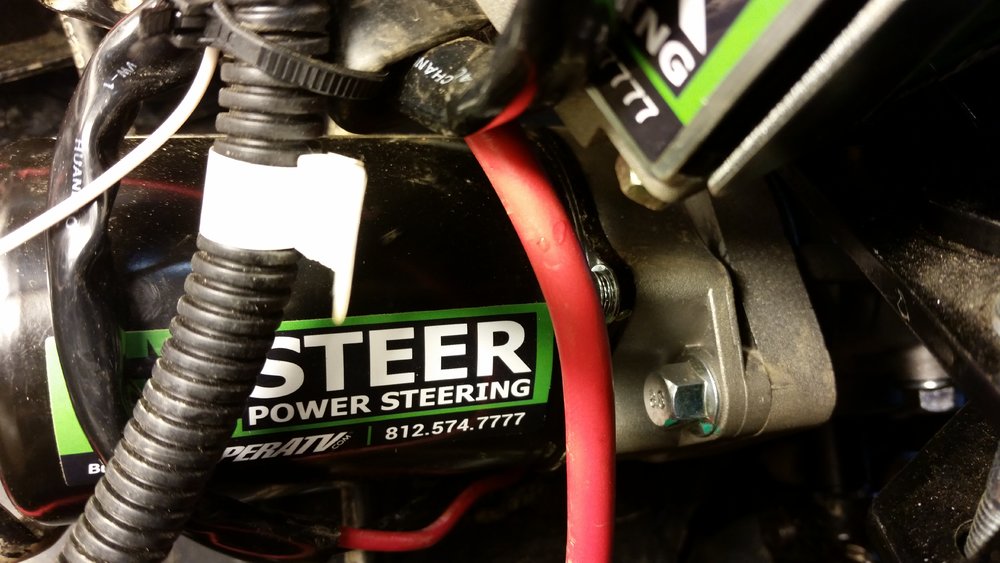

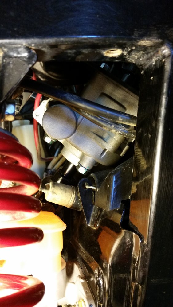

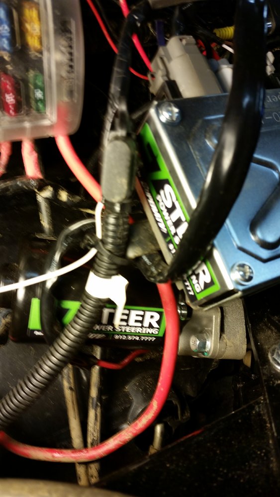

@Mudder and @trigger have a look at these pics ,does it look to be mounted correctly? I also took a pic through the drivers side fender !
20180226 162436 20180226 162323 20180226 162253

@Chooglin , looks like big round part faces down, looks good to me. Wish I did the PS from day 1.

I downloaded the pdf instructions from superatv site and I think I found the pictures that you guys are referring to. These pics look nothing like the pics on the instructions that they sent me in the box. This pic is way wrong , just like you guys said.
