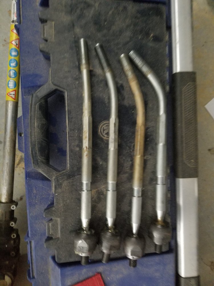

Did you check the tie rods and see if one or both are bent? They are the weak link made to bend in a hard hit vs. A arms or frame.
I will check the tie rods. Do I have to remove them to see? I haven’t pulled anything yet. Was hoping I could adjust something to correct the issues.

I agree with checking the tie rods. sounds a lot like what happens when one of them bends
Absolutely. I've bent tie rods before with the same results he's seeing. Straightening one is next to impossible. IMHO, I'd simply buy another one to replace the bent one.

Although your photo looks like you have more Camber than Toe, I'm with @JACKAL and @Gem99Ultra .
Check your tie-rod. Check the jam nut on the tie-rod. Some of us found them to be lose from the factory.
Set the steering wheel back straight (like it was before the impact) then look at the wheels.

Glad you got it fixed. I read through all of this to make sure I didn't repeat what someone already said. My steering wheel has been off center since day 1. I just ignore it. :)

Yeah, even after replacing tie rod the steering wheel was still off a little. Just pop off cap and remove bolt. Realign the steering wheel and tighten back. All straight now.

Glad to hear it was something replaceable rather than a tweaked frame.
