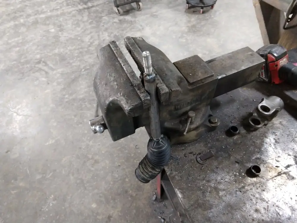

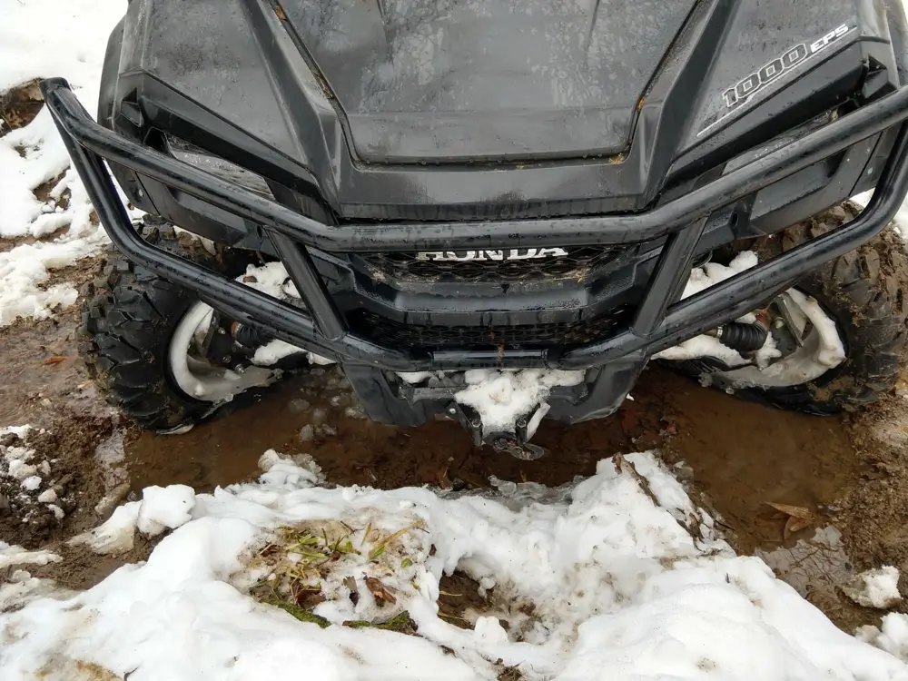

5/8" sounds about right, I would also sleeve my tie rod ends I had done my right side one earlier and had not gotten around to doing my left one so I got to do it today, my 14 year old daughter called me and said she was crossing a ditch and the tires turned out this what I found. :)
View attachment 107679 View attachment 107680
