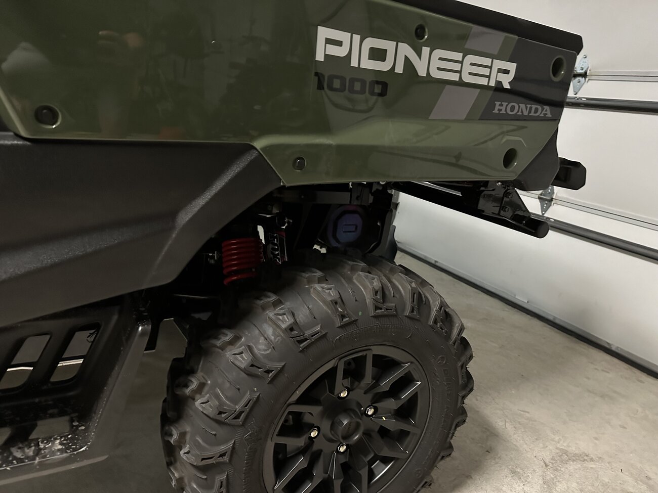

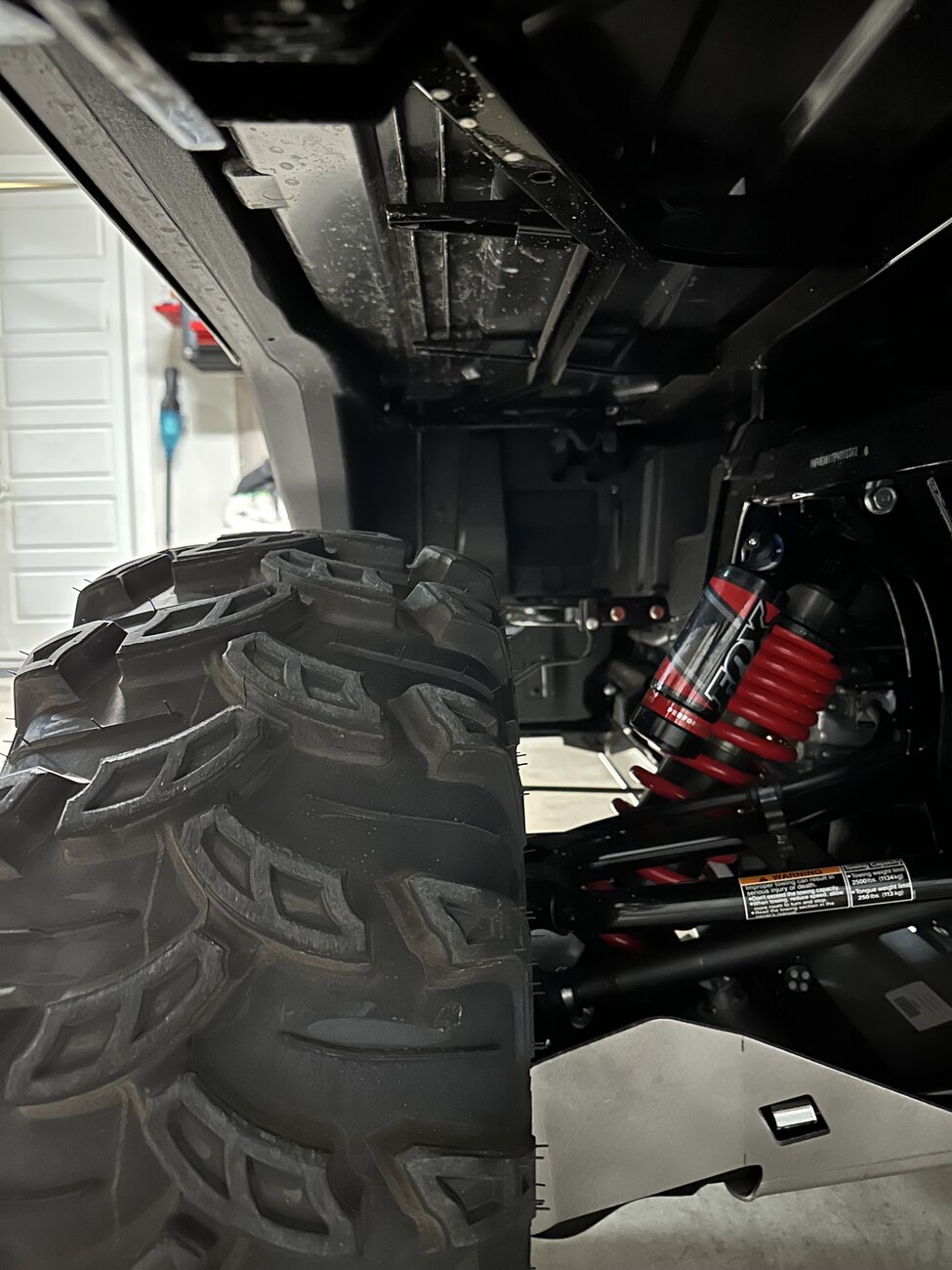

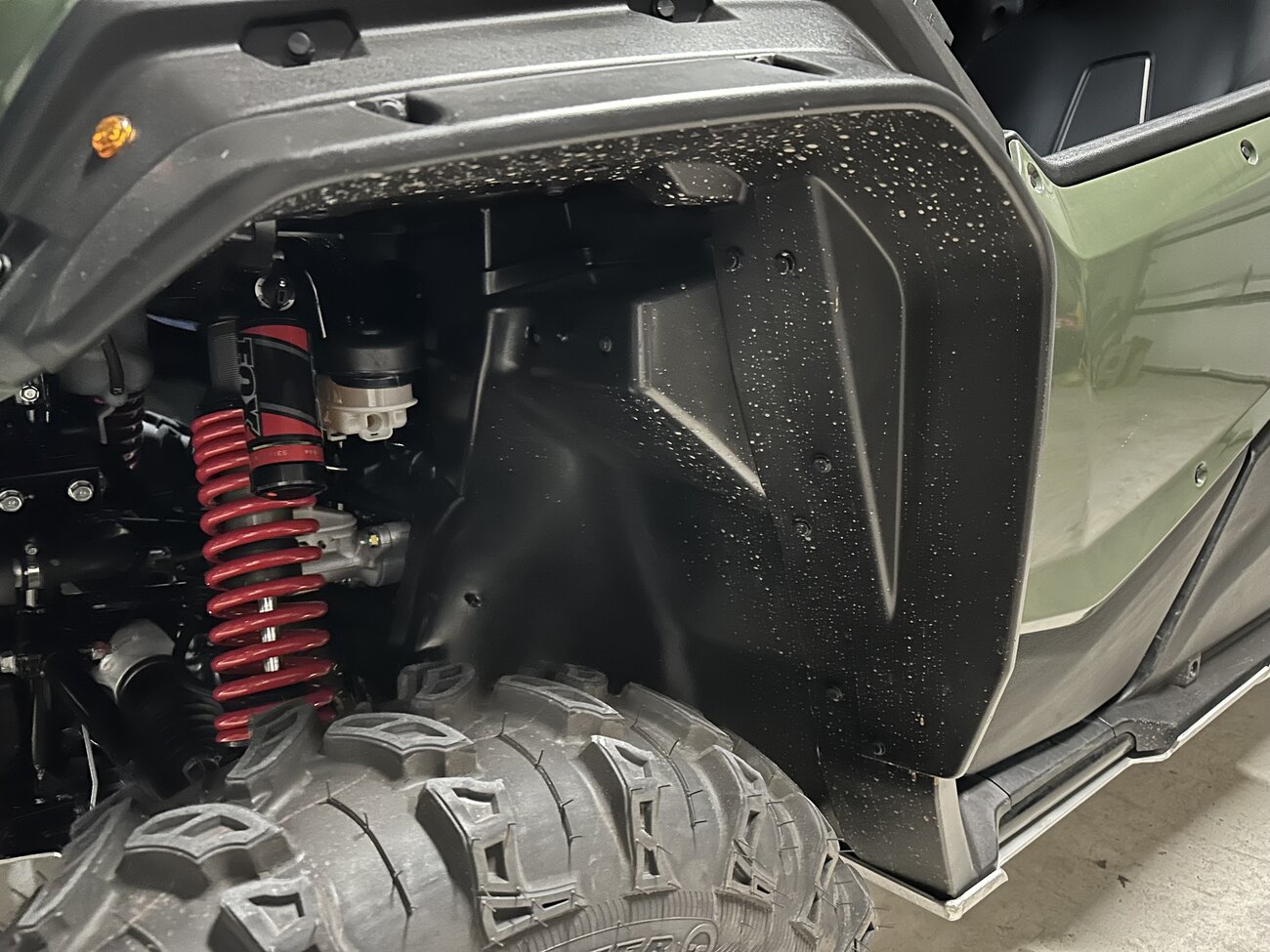

Hard to tell from the pictures, but I think your rear shocks are on the wrong sides. Very important to fix it or you will damage your brake lines/a arms.
The reservoirs should be pointing towards the front of the SxS, not the rear. Just need to swap the shocks a you'll be good!
I'm getting the rears ordered for mine too!!!
Looks that way to me too.

Thanks for everyone’s input.
I ended up going with the Fox 2.0 Qs3. It rides like a cloud. I did confirm the it is just the stiffer spring in the rear is the main difference but for my use nothing I really need to mess with. I can swap out springs and have reached out to Shock Therapy.

Thanks. I noticed that they are backwards after I posted my pics becuase someone else brought up with the comments about them being backwards and having damage etc. super glad i went back to post these pics becuase it ended up saving me a ton of trouble and expense. The sad part is I even had the dealership install the shocks when they did everything else. They put them on backwards. I guess the saying is Trust but ALWAYS verify.
I’d be having a talk with said dealership. They owe you a few bucks or their time to make it right.
Good deal! NEVER trust the dealerships 😉. Shocks are one of the easiest replacements, but I'd still let them know they screwed up!!!

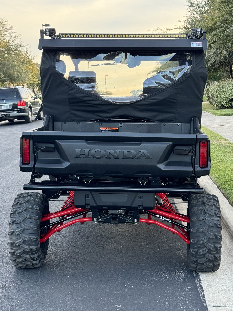

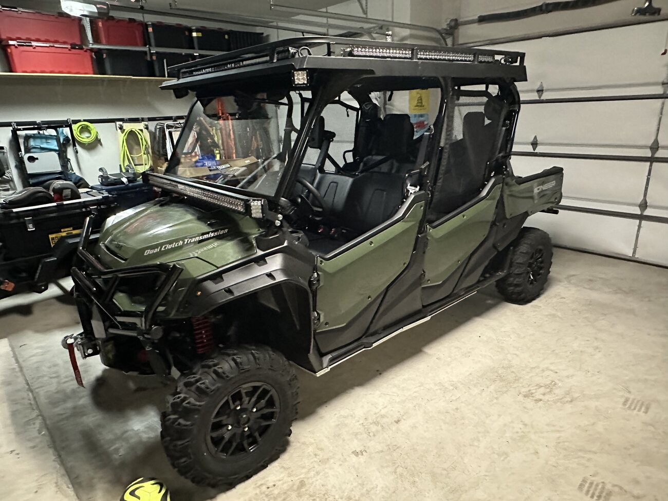

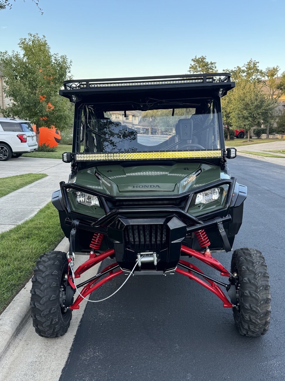

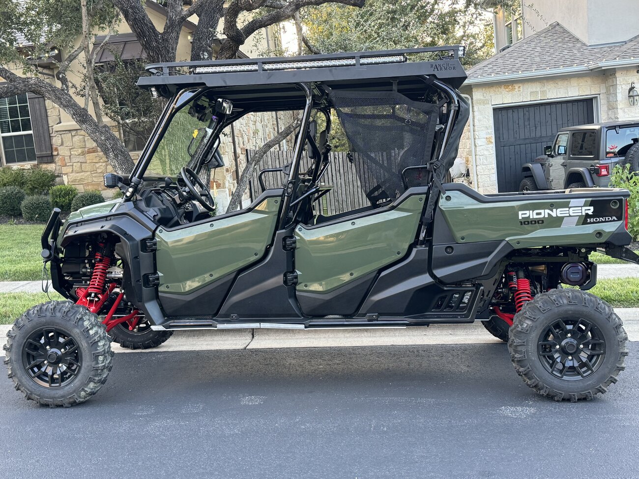

IMG 0138
Finally finished build for now. I ended up going with the box QS three shocks and Texas tub customs, which makes it look pretty awesome. I know I need new tires and rims but kind of tapped out at the moment. Does anyone know if you wentfor now. I ended up going with the box QS three shocks and Texas tub customs, which makes it look pretty awesome. I know I need new tires and rims but kind of tapped out at the moment. Does anyone know what the biggest tire you could go to without causing stress or strain on drivetrain or components etc.? IMG 0137 IMG 0139

Finally finished build for now. I ended up going with the box QS three shocks and Texas tub customs, which makes it look pretty awesome. I know I need new tires and rims but kind of tapped out at the moment. Does anyone know if you wentfor now. I ended up going with the box QS three shocks and Texas tub customs, which makes it look pretty awesome. I know I need new tires and rims but kind of tapped out at the moment. Does anyone know what the biggest tire you could go to without causing stress or strain on drivetrain or components etc.? View attachment 408606 View attachment 408607
That looks good and basically what I'm going for! Is it the 6" lift? Also, what axles did you get?
The biggest tires you should get are 30". Anything bigger and you really should get an igr. 30" in my experience ar emore than enough and work great.

why do you say 30 inch versus 32 inch?
To answer your question.
TTC is awesome and Jared was great Super helpful, answered all of my questions, and I would buy from them again in a heartbeat.
It is the 6 inch long travel kit. https://www.texastoughcustoms.com/product-page/ttc-6-long-travel-kit-bare-metal
I also got the Cobra Axles or king Cobra Axle level 2 so if I ever went to portals or a super huge tire, I already have the drivetrain, locked and loaded. They also are close to Texas tough customs, which means that they made sure that the axles I got would fit the pioneer perfect. I read too much bad stuff about the boots on the rhinos and such and this company makes some of the best ones that are bulletproof Honda Pioneer/ Pioneer limited Extended Length (level 2)

The 32" put a lot more strain on the drivetrain, especially when under load such as mud or a lot of weight. They're much harder to turn without igr. Plenty of people run 32s, but it's not worth it for my riding personally.
