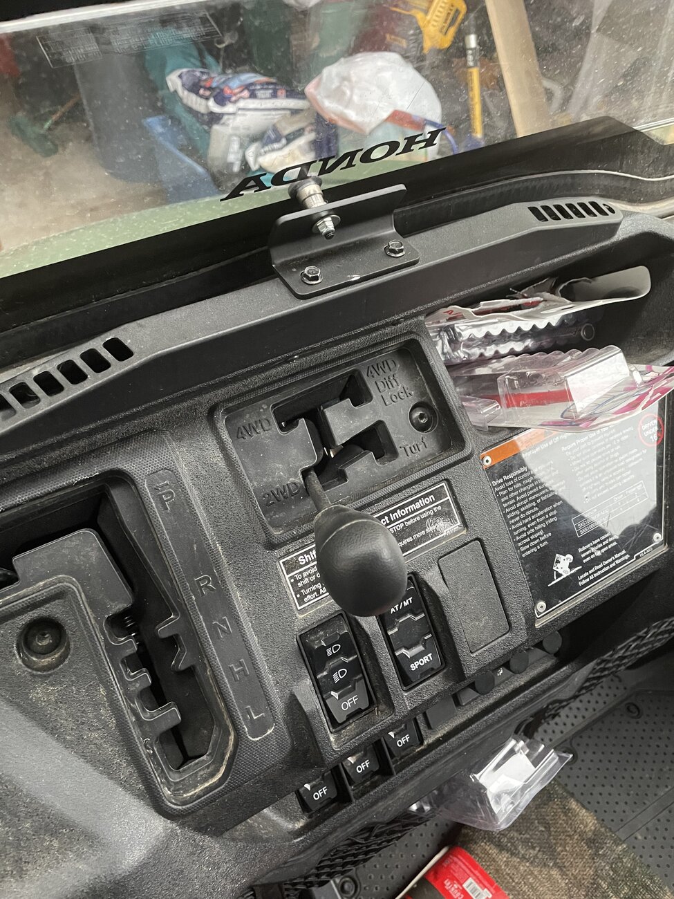

So I start the machine up this morning and it seems to be working fine. It only quits working after you drive for miles, is the blower motor over heating? Is the outside air temp (32 degrees) affecting something? This is also the bracket job the dealer did because Honda doesn’t have a proper bracket from their own products to mate up with the defroster vent! Why is Honda so far behind on this stuff
Also that bracket is bulls***.
Your given a bolt to attach the bracket shown to the windshield. They mounted the vent and didnt line it up with the bracket/windshield first. Your dealer is a bunch of hacks.
I'm guessing this guy's onto something. I don't have a heater and run the Honda soft doors. I've spent some time sealing up the large air leaks and with the fan motor inspection door off I plow snow in a hoody. As for the intermittent issue we had Ford vans at work between 08 and 2012. They would have the resistor get hot damage the switch and motor windings. Until it was all replaced at the same time along with the damaged mulex plugs the problem would continue. We never found a route cause but something in the oe set up took out the rest of the circuit. This was an issue on 20ish vans. One of mine actually had the blower speed switch glowing and melting.
