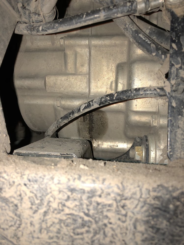

Well the original dealer I bought it from wouldn’t help me at all so I took it elsewhere. I’m guessing they think that it has been is because I have all my vent lines up and the snorkel. They said they would have to wait until they took the engine apart to make a final decision to see if it will be covered so I’m waiting to hear back on that.
I guess the front differential was leaking also due to a pinched vent line that I had installed so that’s gonna cost me $250. I had no idea that it was. As far as the rest I’m still waiting but should be covered. They said the Honda rep that came and looked said he was concerned due to it probably being in very deep water in which it hasn’t.
I found some paperwork today from wen I first took it in at 196 miles complaining about some of these leaks. Paperwork stated to clean the areas and monitor. Honda said it was normal break in. Not calling down This dealerships because they really have helped out. Just nervous to see what they say when they take the engine out because there shouldn’t be a speck of dirt, water, or whatever else in there. I don’t think the machine has 1000 or maybe a little over. I wish I would have wrote that down before I took it in.

Well now I’m officially pissed! Guess Honda isn’t gonna cover this due to cold water hitting the hot engine. Saying it’s water damage. I’d like to know why my 07 Rancher and my 15 pioneer never had this issue. I told the service department that I want someone from Honda to contact me and discuss this. Cost on my part so far is up to $650. Just a warning don’t go in water above your floorboards.

Hi, I looked carefully at 2016 P500 and I don't recognize the pictures you are displaying. The engine may be correct, but it could be a view I can't duplicate without disassembly. I also don't understand what they are trying to show you, I assume it is the dirt spot on the head, which I would consider normal for a vehicle designed to be driven exclusively on paved roads, not one that specifically designed for off-road use. As for being "swamped" how do they define that, I didn't see any water and/or mud in the air cleaner. I used to ride motorcycles, Honda, Kawasaki etc. and that looks really clean to me. I used to run through the creeks and mud holes and never had problems with the aluminum engines leaking oil because of it. I think you need to get more information from the dealer. My 2016 P500 looks much worse than the pictures. Also, what does winter have to do with driving P500, bundle up and have fun busting through drifts on your way to the grocery store

The picture I posted shows a seeping spot on the crank case and I guess there Is also a leak around the cylinder that looks the exact same. The pic is the crank case right below the battery if you are trying to picture where that spot is at lol. I have so many pictures of all this stuff and its getting confusing. This is a 2017 machine and have had problems since 200 miles.

An Email I got from the Honda Rep that has been working on my machine.
As we've concluded based on extensive unit evaluation. It is extremely probable, Mr. Johnson's Pioneer 500 is used in an excessive amount of water. Typically, in an off road recreational environment mud is associated with water. These conditions can lead to early wear and deterioration of drive train components including (but not limited to) seals and gasket.
In the interest of customer satisfaction and education. I am willing to provide the benefit of the doubt and repair the rear output shaft seal and rear engine cover sealant. This will also provide us the opportunity to verify the integrity of the output shaft sealing surface and associated parts. As this requires the removal of the engine, it provides easy access to address concerns at the front of the engine.
With regard to the front engine leaks:
If you see any debri were the front drive shaft mats to the output shaft take photos of this.
Regarding rear differential seepage:
Verify the oil height and condition
Verify his vent line extensions are free from clogging
Provided diff oil and height are in good condition, proper height and vent lines are not obstructed warranty will cover rear diff re seal.
Regarding front differential concerns:
Based on the after market vent line extension pinched at dash, this will be Mr. Johnson's responsibility if he would like it repaired
Replace throttle cable under warranty
Recommendations:
Prior to starting repairs, contact Mr. Johnson, advise his unit exhibits signs of use in excessive water. While you are willing to provide benefit of the doubt to address his current concerns, should discovery of additional problems with in the engine be discovered, the repair cost may be his responsibility...
Document current oil and height conditions (engine and diff) note also coolant level.
Would show customer jammed air filter bracket.
Customer will need to pay for the engine oil and filter based on current condition of oil and no maintenance records provided.
Please document on the Repair order that the unit exhibits signs of usage in excessive amount of water and mud, reference page 85 of your owner's manual regarding operation in water. As reflected in your warranty booklet. Misuse is not covered by Honda's express limited warranty."
