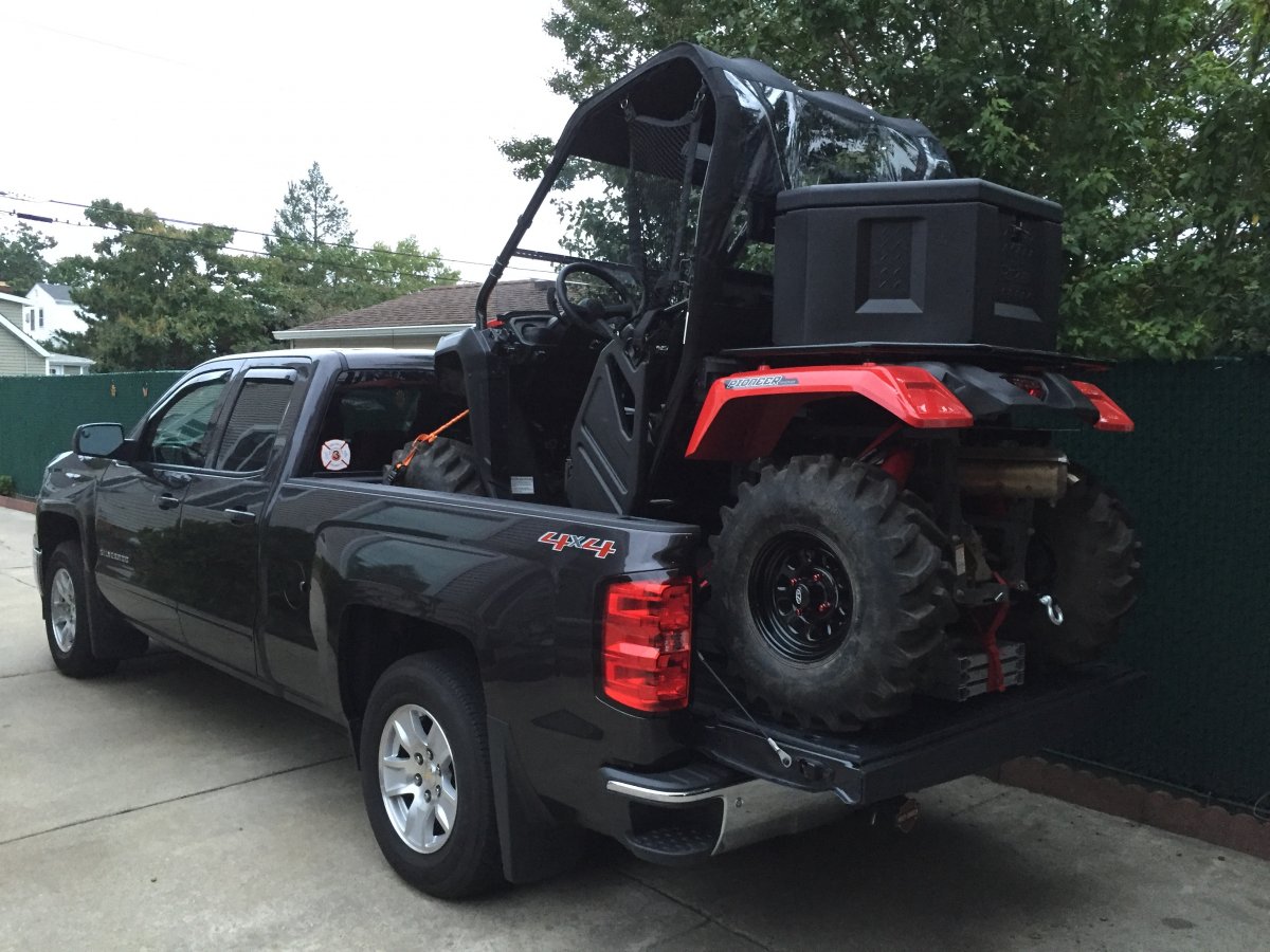

The other thing I like about my ramps is I can use them outside the truck to do work on my P500. :)Hi Ovo, just joined the forum but have had my eye on this. Wondering why you went as high as you did? Looks like you were trying to get over the wheel wells. Was that so you could use the same rig to load a wider machine or for more storage underneath?

Hi Ovo, just joined the forum but have had my eye on this. Wondering why you went as high as you did? Looks like you were trying to get over the wheel wells. Was that so you get use the same rig to load a wider machine or for more storage underneath?
Originally it was to accommodate the short box truck I had (F150 6.5ft box) to shorten the overall length. The P500 will drive easily between the wheel wells on all full size pickups. Hope that helps.
