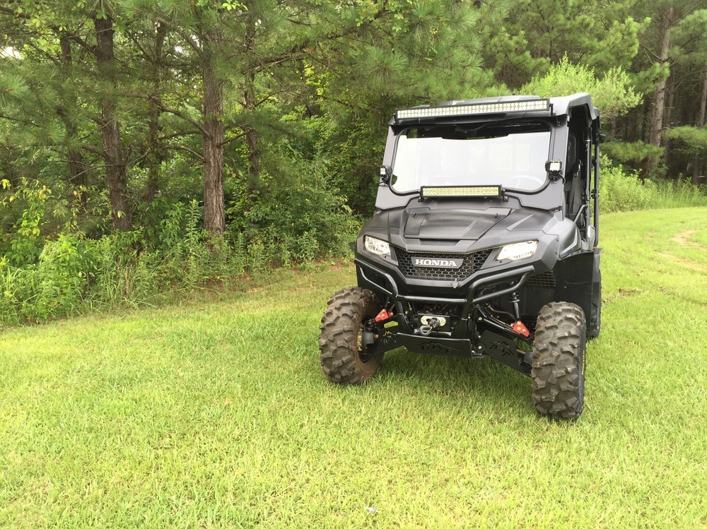

P700 Just finished installing all my aftermarket accessories. What do you think?

Looks good! Dont forget about tires. Those 4 ply tires have given people issues. Not fun when way back on a trail.
Already had an issue on my 2nd ride. Problem I have is currently I'm renting a house trying to buy. The machine had to be in the garage due to HOA. I want to change tires but it won't fit in garage.
When it's time, what tires do you suggest?

Depends on the riding you want to do. Id suggest at least an 8 ply tire. 26 or 27 for trail riding. The bear claw HTR are good all around tires on the 700. Not my favorite looking, but they perform well. Probably my favorite tire performance wise ive owned so far. My next tires will most likely be Blackwater Evo's though. Or the EFX Motoclaw

I got the half windshield from the dealer when I purchased. They gave me 25% off and I went for it. Love the half windshield and highly recommend.

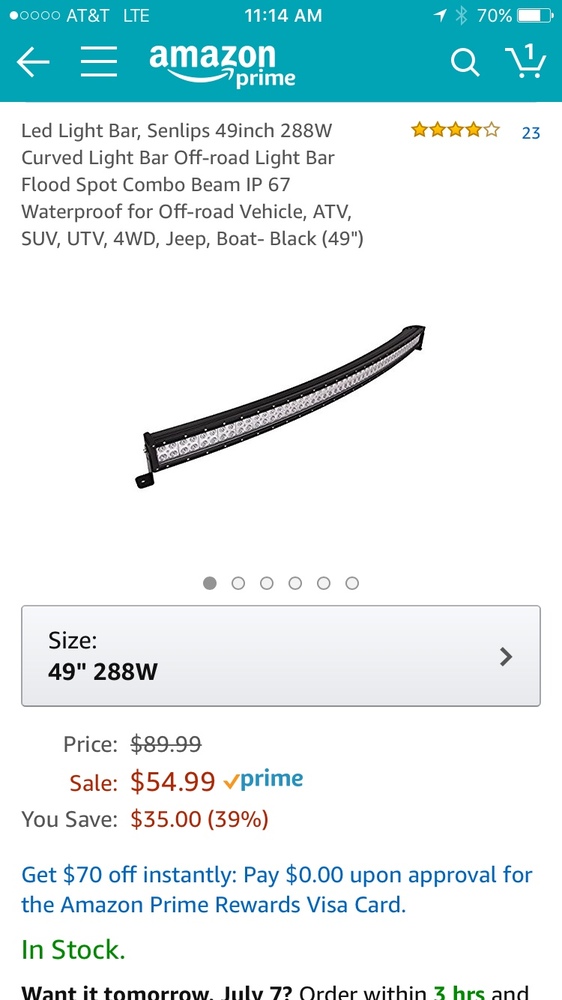

Light bar was Amazon purchase and well worth it. You have to have 2nd battery.
I had a friend with a machine shop cut the brackets. They are custom to fit the light bar and install in the 2 screws that hold the door net. You have to take off the door net to install brackets.
I just texted my friend to ask him how much for a pair of brackets. Will let you know when I hear back.
Congrats on the purchase! Now comes the real fun! Let me know if you have any questions.
2nd battery? I have seen other post talking about installing a 2nd battery but I assumed it was -in case of emergency- I didn't realize I would need it to operate a light bar and other accessories. Where did you install it? Also, do you just connect it to the original battery for power draw and charging? Thanks for the reply and I hope you don't regret telling me "let me know if you have any questions" lol because more are coming!

Second battery under driver seat with a True isolator. Then run all your accessories of of it. Isolator will save/ disconnect main battery from secondary preventing main battery from being drained.
Yeah! What he said!
I put my battery under the hood to make it easier to connect all the accessories. I had some help but you can find all the info you need on this forum. Isolator is a must and easy to install.

Ran into this issue with my 700, I had 28" Evos and a 3.5" lift. I had to hang off the hitch while my wife backed it out of the garage at our old house. 1000 is actually a bit shorter and we have 8' high garage doors.

Man that rascal is fine! I just bought the exact same bike and I would love to do some of the same accessories. I was thinking of the half windshield and after seeing yours that's definitely the one I want. If I may ask which one is that??? Brand etc? Also, which light bar do you have but more importantly did it come with mounting brackets? If not which brackets did you purchase? Thanks in advance for any info!
Go with a two piece windshield. You can run the lower windshield during summer months and in the winter run a full windshield .

I put Sedona Rip Saw R/T (Radial) tires on mine and went one size up to 26". I have been very happy with them so far in both ride, puncture resistants, and steering and handling. I'm not a huge Mud Runner, so I can't say how they would do in the sticky stuff.
