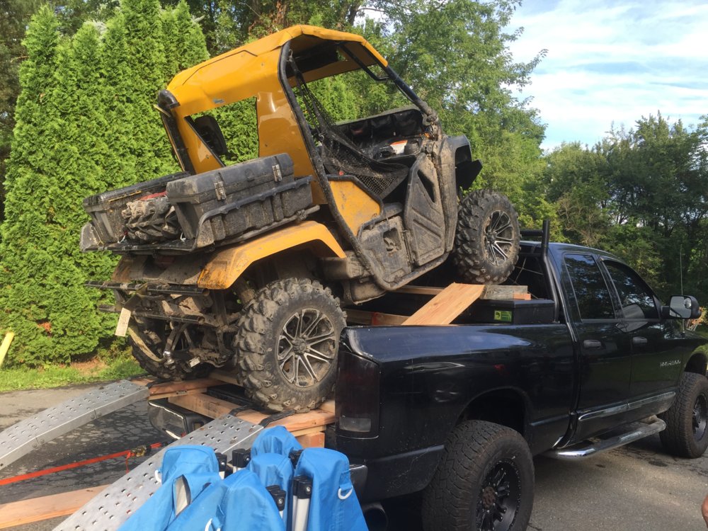

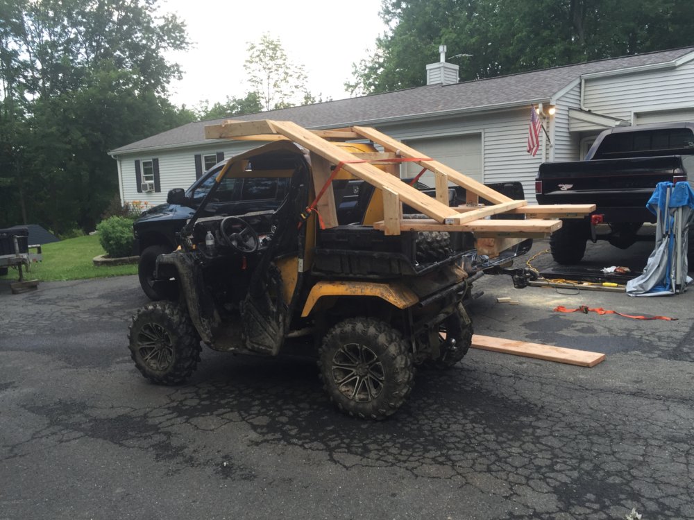

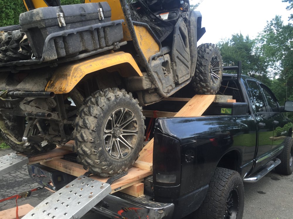

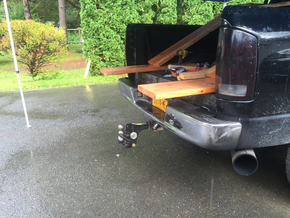

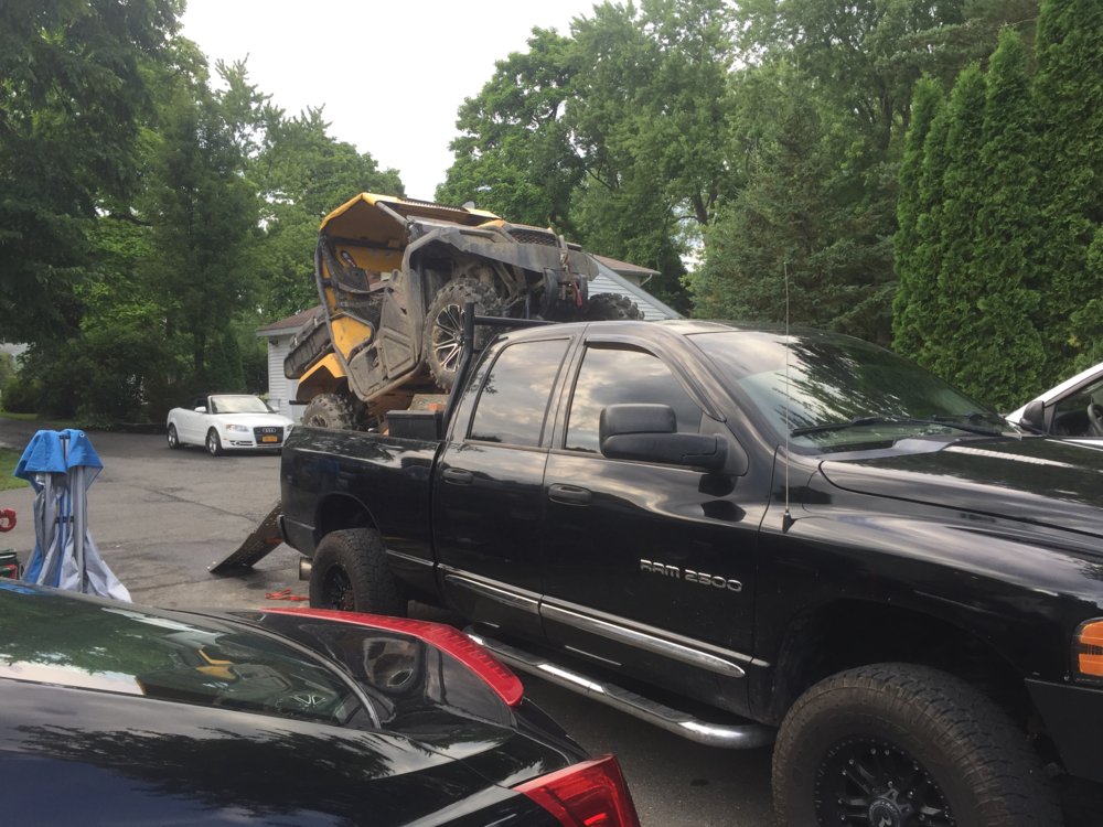

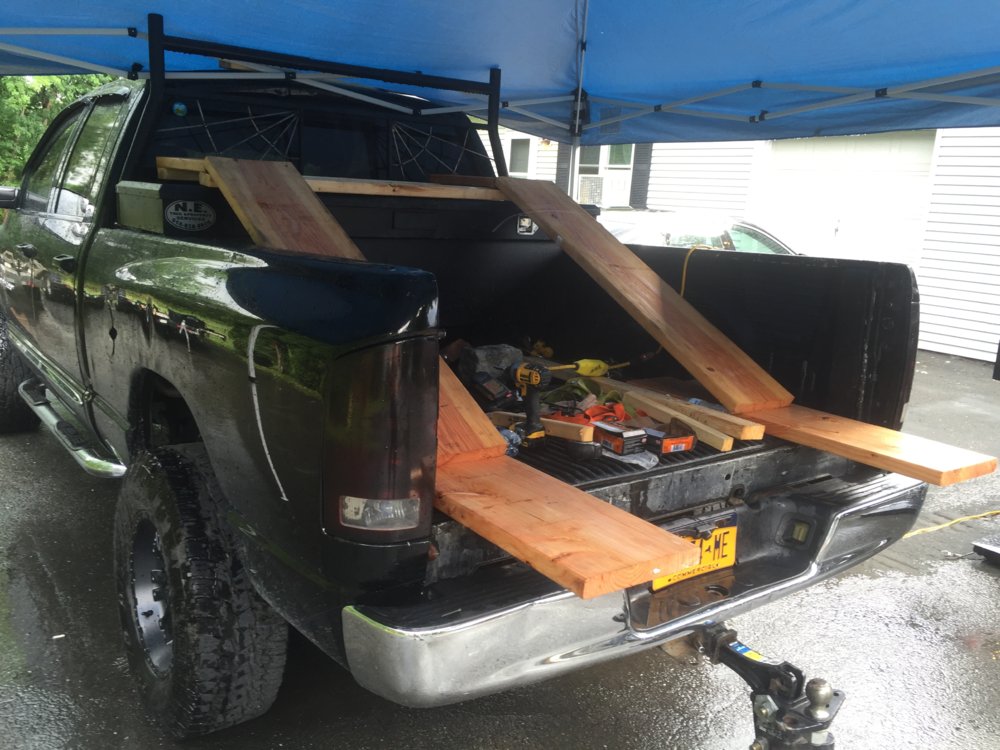

Think I'm on to some thing here
Image Image Image

I have a idea to put the front tires up on the toolbox as close to the cab as I can get it and maybe have to have the rear sit on bumper or a ramp but I think I'm gonna build a rack to go in the bed I wanna keep the motor of the p5 down low so I don't have a higher center of gravity and also I don't want my roof of the p5 to be 15 feet off the ground even if I do the flat bed I feel it will be inches to short (bodies is 84" long) but airbags Had them on my halfton towed anything definitely putting them on this truck as well
Yeah, puts it up in the air too high. I'll be taking my toolbox out to haul it.

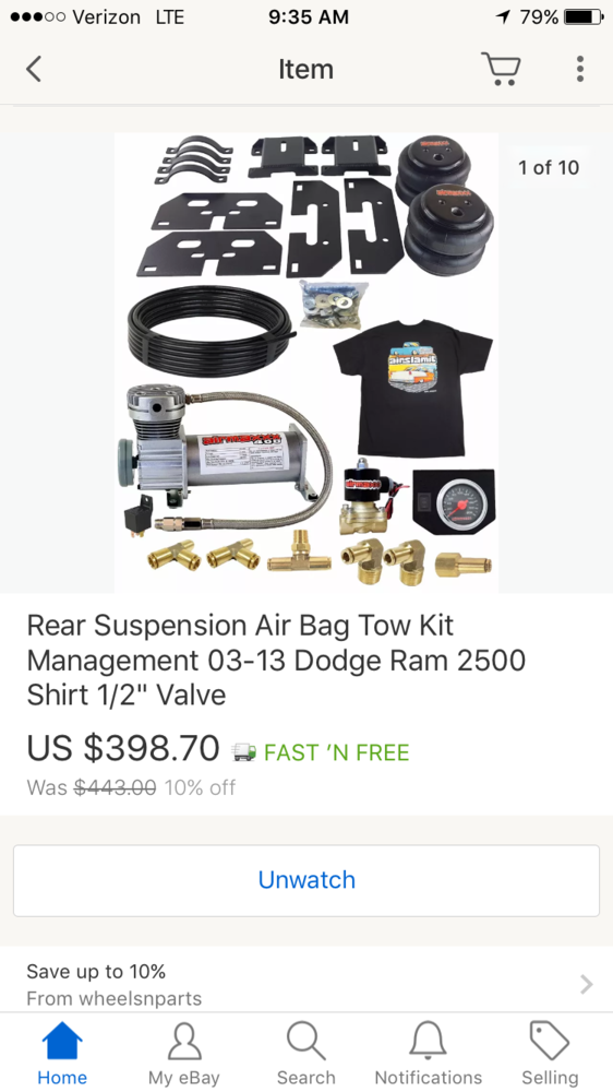

Just ordered this set for my 3/4 ton my half ton was hooked together no check valves and I never had a problem with body roll see if this kit has a check valve or plumed separate

To each his own. Check my avatar to see why roll is of concern to me. Tall camper.
You might run into that with your P5 perched way up yonder too. Individual bags WILL control body roll, and hooked together bags won't.
The need for a dedicated compressor and in-cab adjustment completely escapes me. A Schraeder valve in each wheel well works great, and cuts costs by more than half.
Most people who badmouth airbags complain about problems with compressor and the in-cab stuff, not the bags. The bags are butt-simple, and give no trouble.
I like simple. I like 13 year no maintenance reliability. I needed to air up my tires when hauling heavy anyway, and the bag valves were right there.

Lotsa guys up here use a similar system to what Tmiller is running only out of aluminum. A number I've seen integrate with the bull board on the truck and park front wheels over the cab, lotsa a room then with short box. Then I've just seen one the other day was a snowmobile deck (above box) with a tube aluminum frame that put the UTV front wheels just over cab. In this way gives clearance for trailer pull and no interference.
Tmiller looks awesome my only advice (as I used to use wood loading ramps with my Rubi 500 ATV).. You may wanna put some traction on those planks....rains, muddy and can be an exciting ride.

Yeah I seen them just a lot of money and I don't like the idea of the weight ontop of the bed little to tippy for me my buddy made one but I also put a kit (conpresser gage switches valves bags all the stuff) off eBay in last week it leeked down the 1s 2 days but seams to be good now now leeks works well for now just gotta do something for traction on ramps
