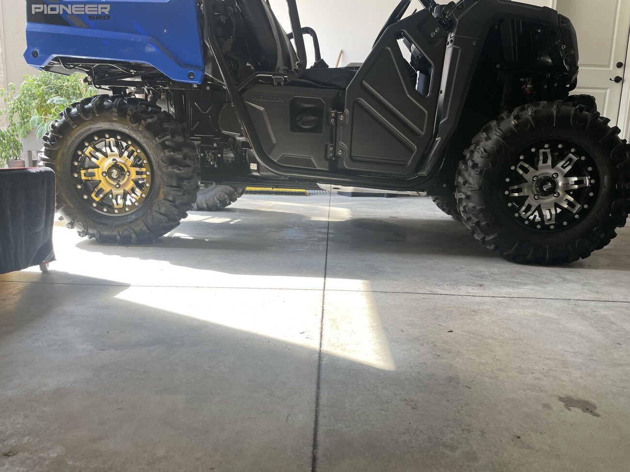

I can finally report back on my Elka stage one shocks that I had sitting in my garage for three months.
first thing, they are crazy expensive. And I’m still puzzled why we can’t have any shocks for these little machines that are in the hundred to $150 each range. But I can tell you the build quality looks amazing and I suspect that they will hold up for a long time, and of course rebuildable at some point in time.
After bouncing around on Rocky trails in Wyoming for a week, I can tell you the ride is significantly better. Yes, I have 27 inch radial tires on the P520, so some of the credit has to go to those big tires with low air pressure. They allowed my wife and I to travel over pretty bumpy stuff at a decent pace. I would say even through the roughest stuff I was going 5 miles an hour faster than I would a year ago. A year ago where I was going 5 miles an hour going from Boulder to Boulder, this year I could go around 9 to 10 miles an hour and felt pretty comfortable.
of course it’s not all about speed, overwash boards and rutted areas the pioneer felt more controlled and planted. I did bottom them out a couple times on some larger boulders hit too fast, but that should be easy for me to fix with a little pre-load adjustment.
in fact this afternoon after cleaning up my pioneer, I started to adjust preload on the passenger side as I’ve always felt like it has listed a little bit to the passenger side. And looking at things closer, I can tell that the front end is sitting a little bit lower than the rear end of the machine. Of course I didn’t take measurements before and after all of the items I added, so I can’t remember if there was a significant difference in clearance between the front of the machine and the rear of the machine. If anyone can tell me if the frame rails are supposed to sit relatively even, I can go out and start making adjustments. To my eye, it looks like the rear of the machine is sitting roughly an inch and a half higher than the front of the machine and the frame rails are not perpendicular to the ground front to rear. If that makes any sense?
The bottom line is, I would totally buy them again. Even at the high price. My wife drove our little P520 around in the mountains and at home after we got back. She pronounced it was a totally different machine now. Some of the credit goes to the power steering which she absolutely loves, but the ride is so much better than a year ago before the modifications happened.

I know it’s really hard to tell here because of the new skid plate to see the difference between the front and rear heights. So if anyone can tell me if there’s a difference between the front and the rear on their machine that stock and I know where to go from here and adjust preload to the front to shocks

Looks good. Like the wheels.
as for pre load its a preference and u will just have to keep messin with them till u get what u like. With aftermarket shocks, no 2 machines are alike. If this is what your asking?

Thanks Remington.
The biggest reason I’m asking about preload is because of the alignment for the front. After I put on the super ATV arched a arms, I noticed that as ride height changes so does the toe. I’m trying to get it dialed in and after looking at the machine a little bit I noticed that it looked like it was a little lower in the front and the rear. So when I had just a preload on the passenger side, I noticed that it was changing the front toe.
that’s of course an easy fix, and I carry a couple wrenches with me every once in a while to just adjust the alignment on the fly.

No prob, yeah every time u make an adjustment something else suffers lol. But at least you have arms so u can do that. Just keep at it, you'll get it.
This ^^^^^
The ride height (what your asking about) is really your preference. Everyone will have a different opinion that is correct FOR THEM. Find the settings you like.
