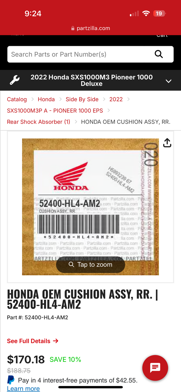

Just checked my old ones while Theo don’t look much fatter the part number is hl4-an1rr

Finally figured it out they sold me a rear shock off a 3 base model saying it was a 5
