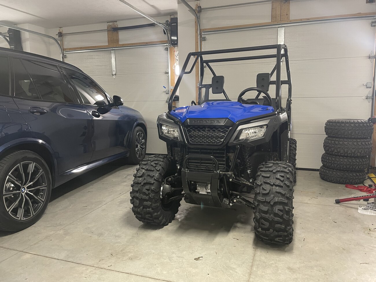

Visual of what wheels and tires do for the P520. You can see the stockers in the corner of the garage. I think it still looks naked like this.

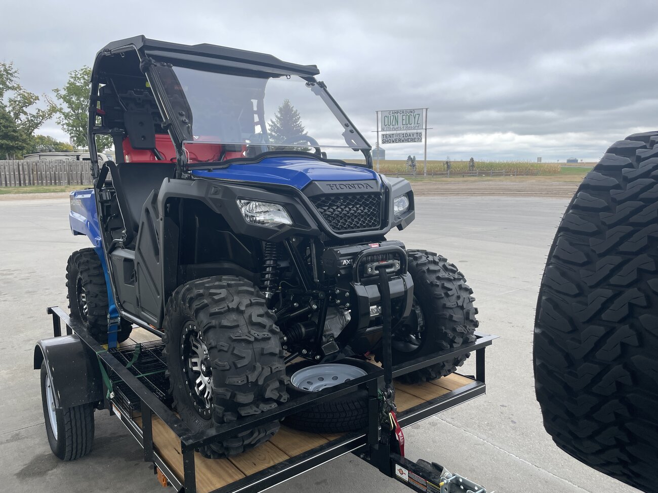

Once you start adding the good stuff, I think it really brings the character of the Pioneers. Here is is with the same wheels/tires, but adding the winch, windshield and roof make it even better.

Hey Rob, what size trailer is that and where did you get it? I like the “just right size’

I’m pretty sure it’s just a TSC (tractor Supply Company) trailer I got from a neighbor who was moving and needed to sell it. It’s a bit smaller than I would like, but fits the P520 perfect. It is a 5’x8’ trailer with the ramp cut off. I use short ramps like these:

I bought the ratchet tie downs, a front wheel Jack and spare tire for it.

No lift kit, I did 1” spacer in the rear to even up the stance front to back. I run the same wheel and tire at all 4 corners. Tusk 14 x 7 bead locks and Maxxis Bighorn 3.0 in size 27 x 11 x 14.

My set up is a ton smoother than stock. The little 24" tires pumped up over 10psi were rock hard and didn't deflect at all. The new set up running less PSI is way smoother.
Staying 50" and going up to a larger 25,26 or 27" tires is a risky proposition . I'm at just over 54" wide and I feel very comfortable on side hills. 50" wide on 27" tall tires would be a real pucker fest.
Look for a thread about 50" gates... lots of discussion on the subject and many more threads about the subject. The old timers around here will tell you the same, " to go up, you have to go wide."
