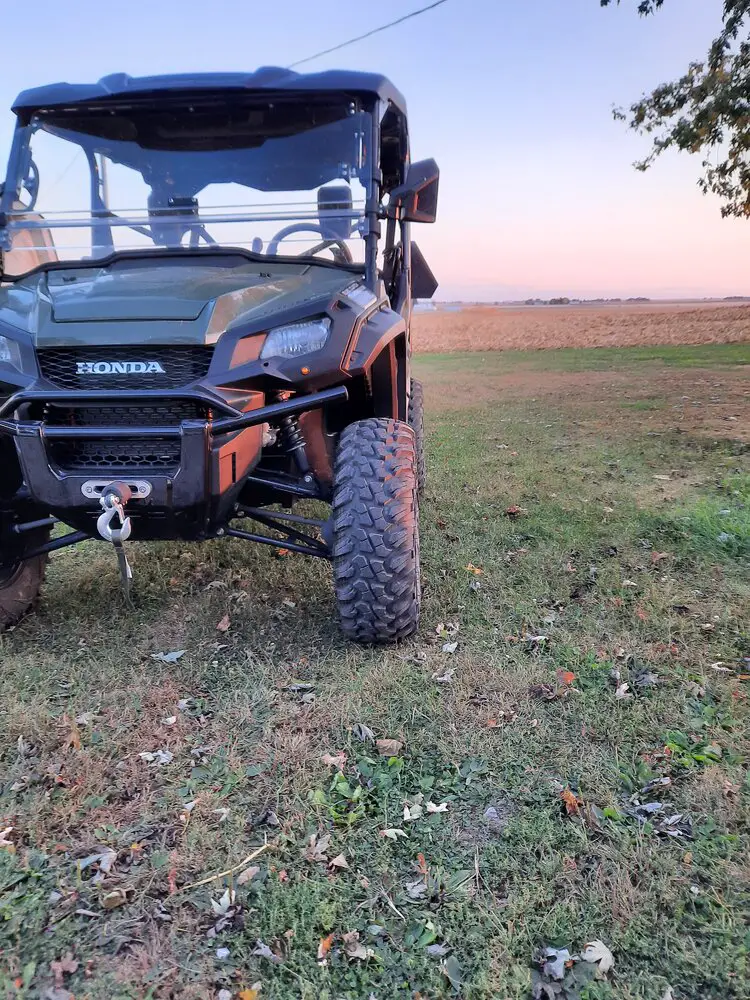

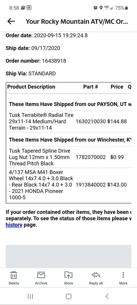

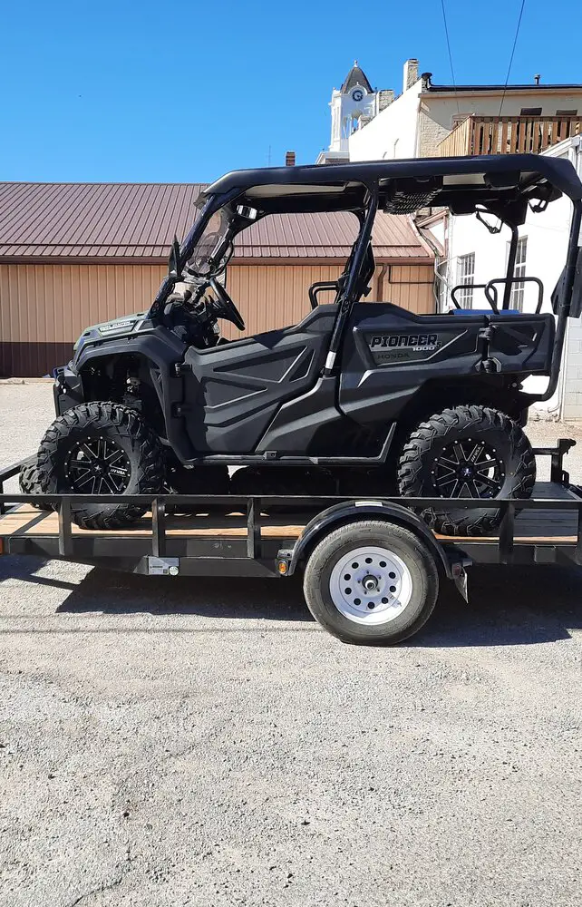

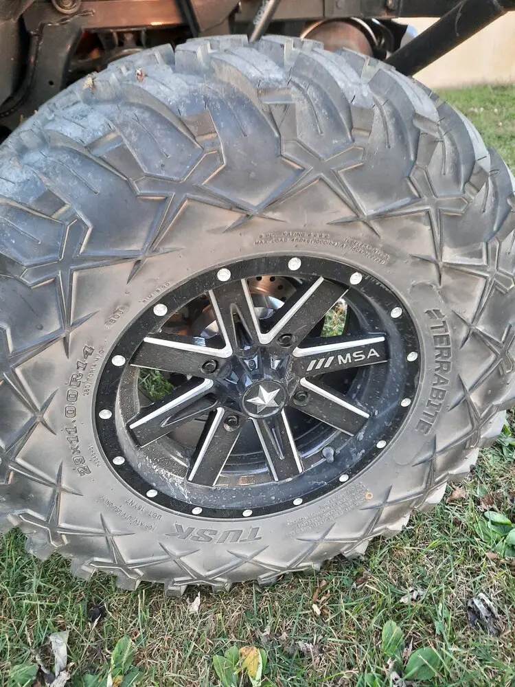

29's fit. I went 29x11-14 all the way around. I put 1.5" spacers on the back to even out front and rear.
