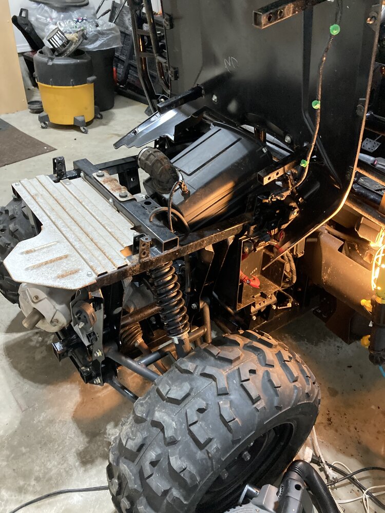

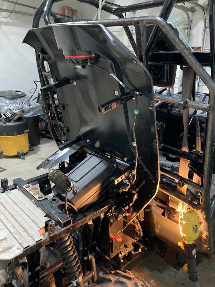

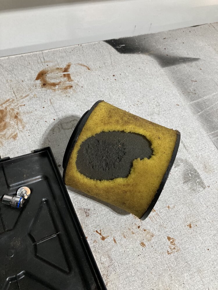

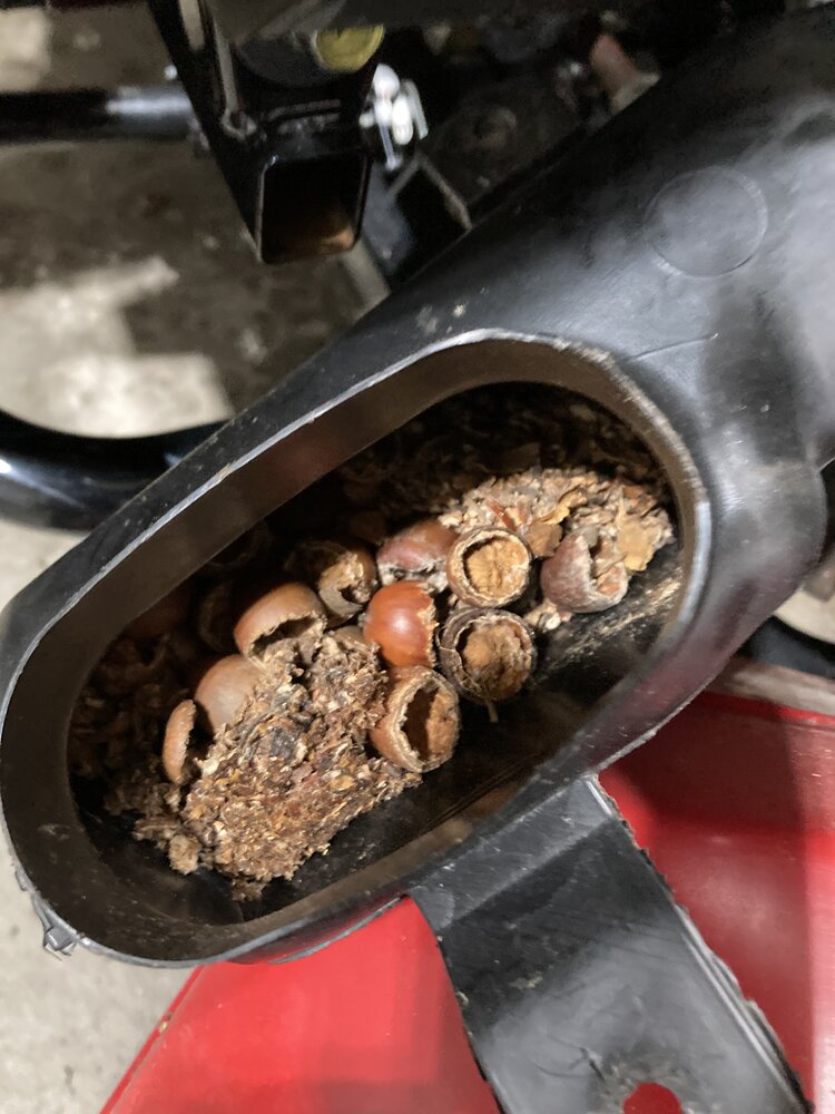

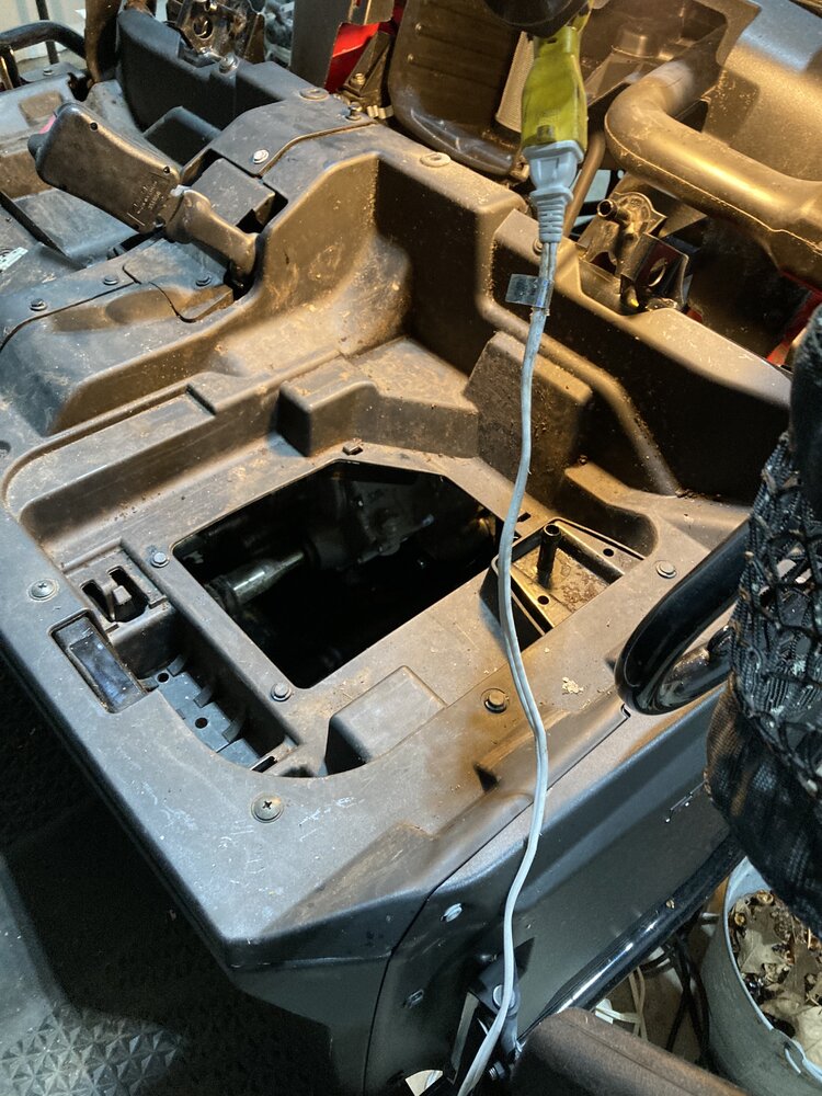

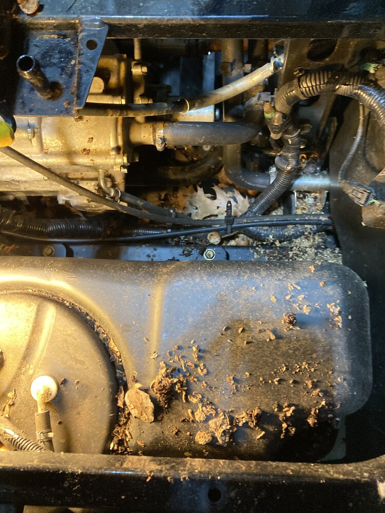

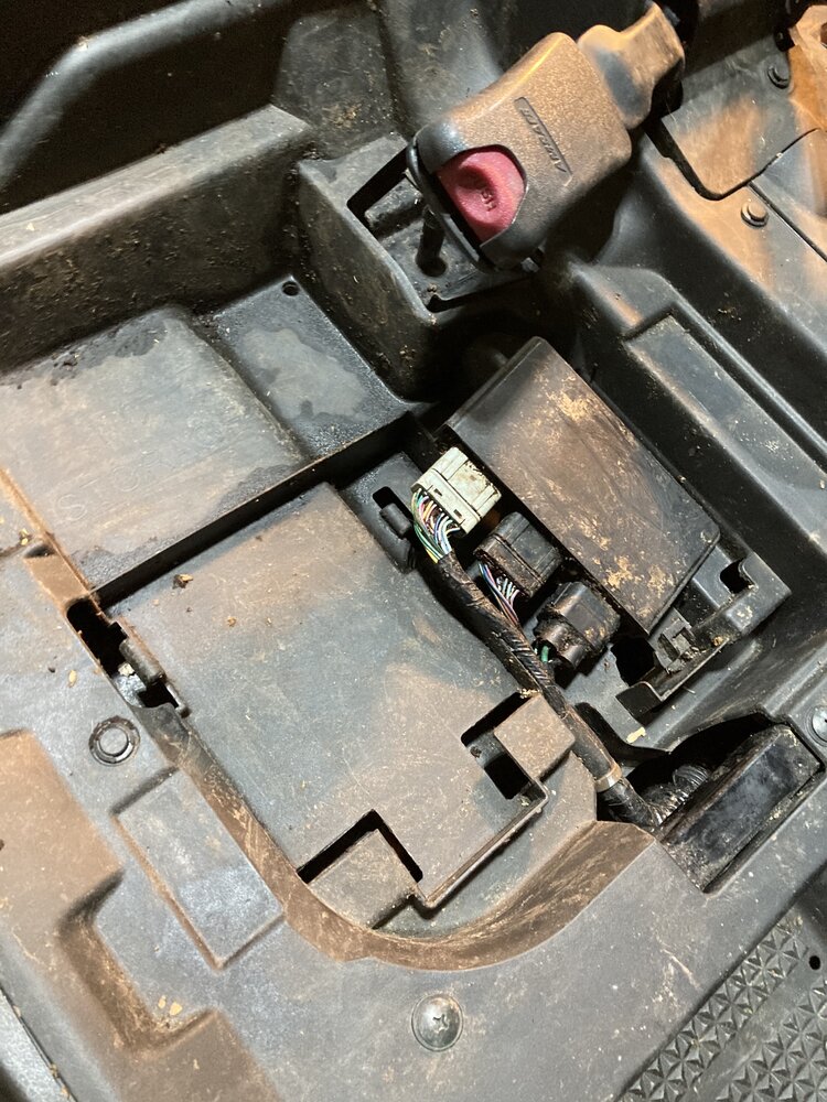

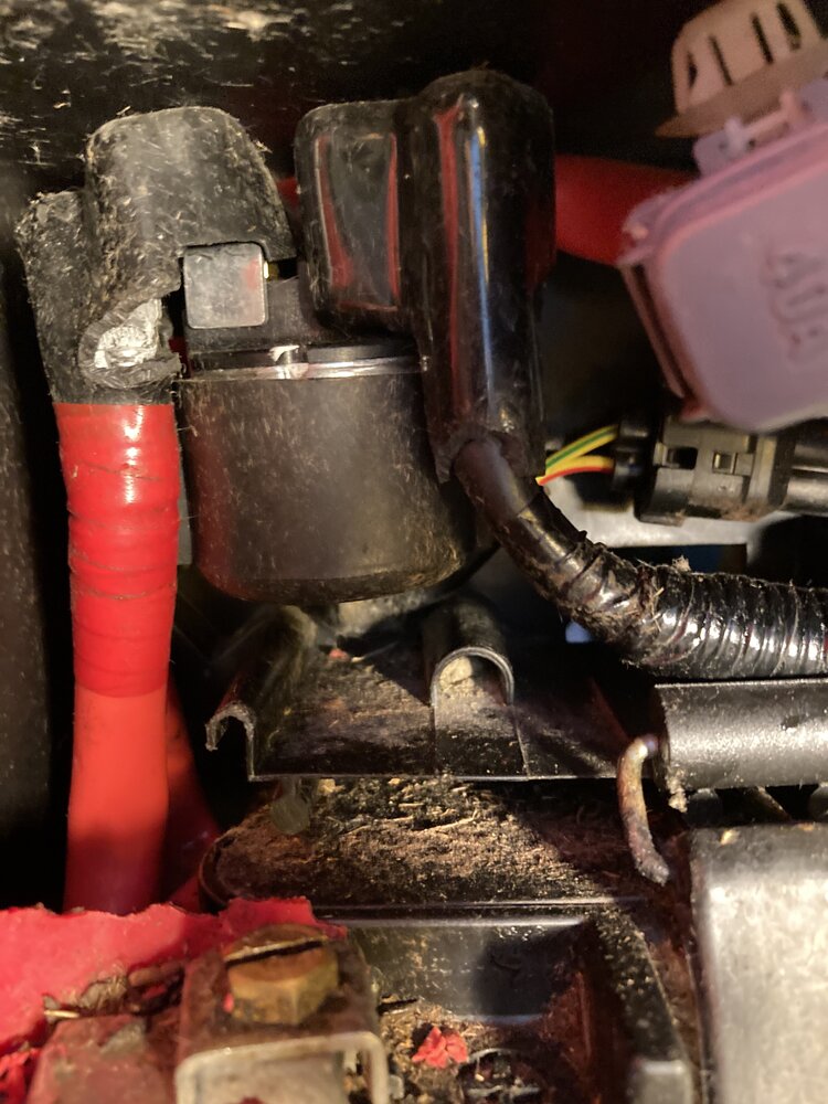

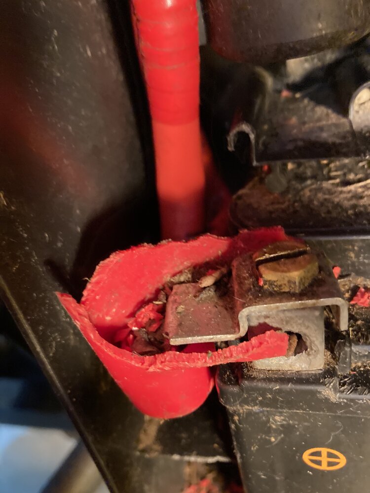

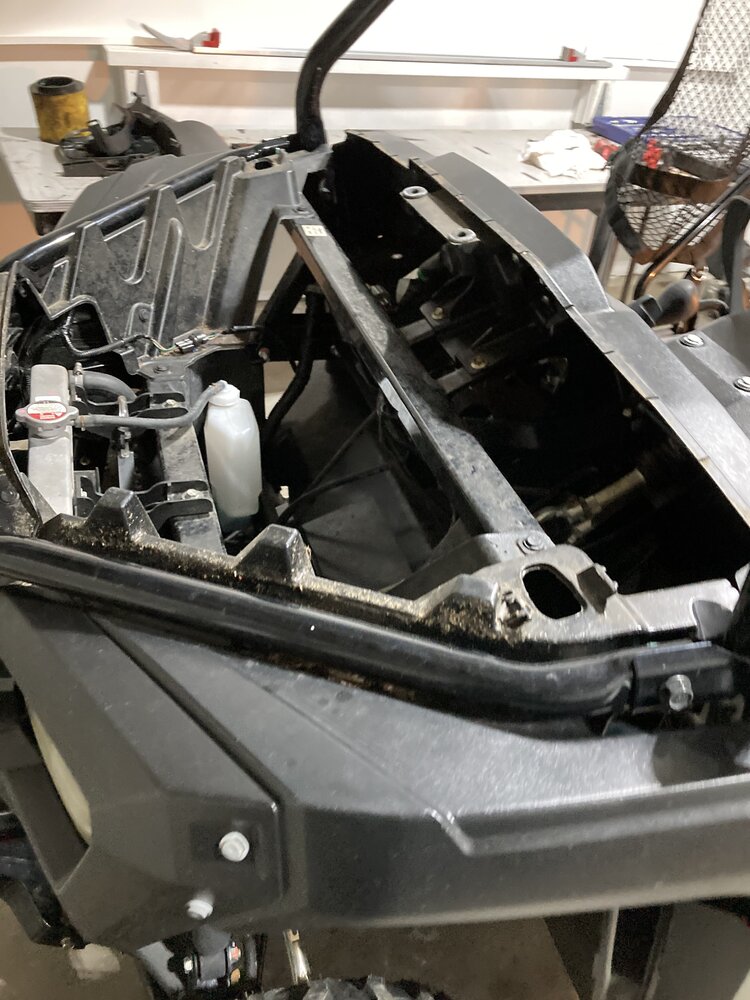

Thank you everyone for your welcomes and advice. Yes, I just bought and picked up tonight. I am 58 years old and always wanted one of these. I jumped right into it and disassembled as much as I could with help from the owner’s manual and you tube.
Acorns and squirrel nets everywhere 4 metal buckets of chewed acorns, dirt and nests. I posted pictures, tomorrow I will pump out gas and buy a new battery. I ordered oil change kit ordered from Amazon fuel filter, plug, and oil change kit.

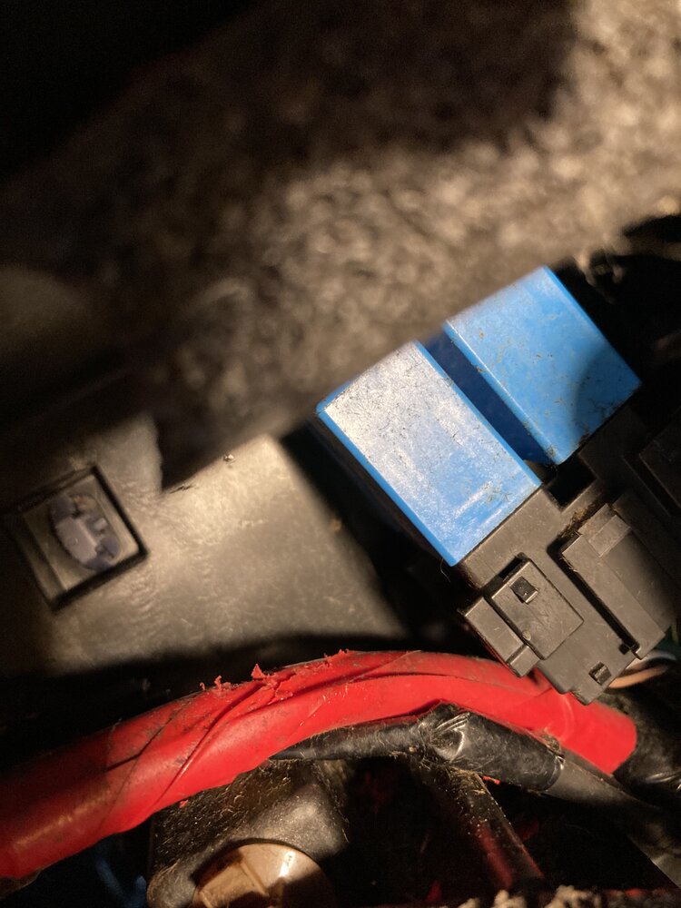

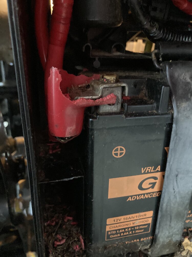

You will be lucky if you have no chewed wires. Good luck

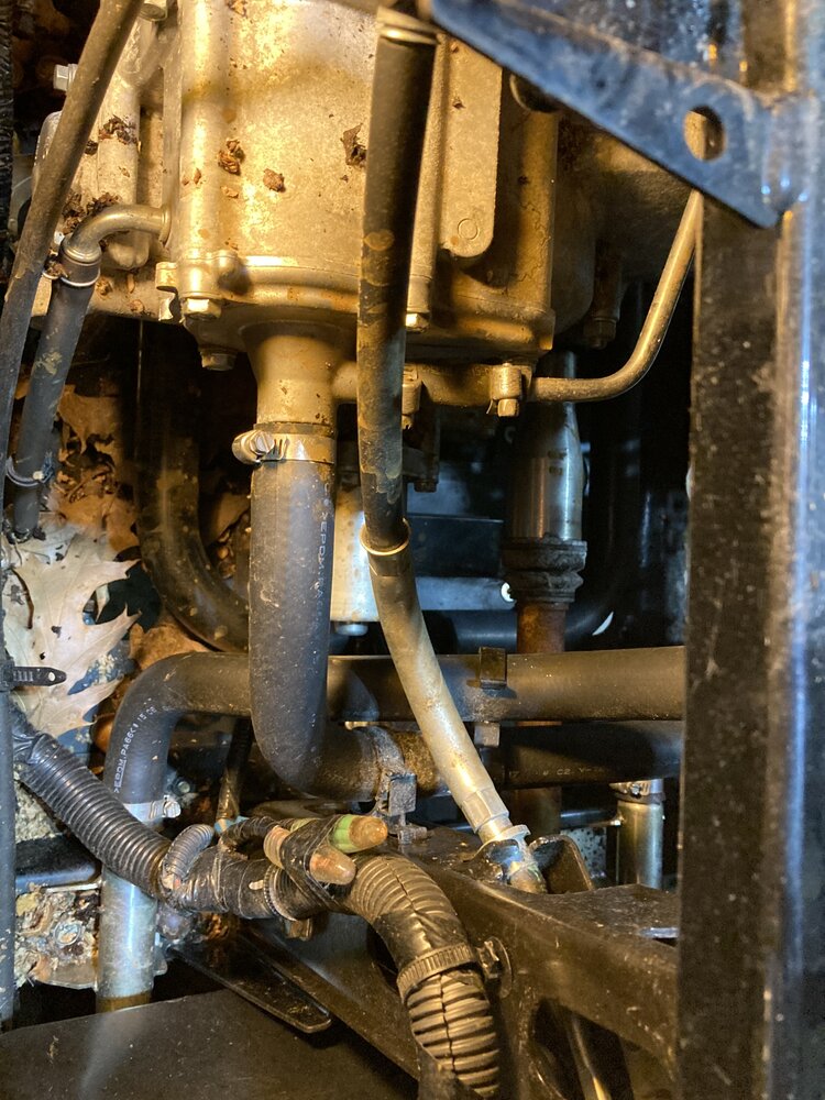

For what it is worth, I would remove the gas tank and clean it (either replace the gas line or blow it out). The reason is, once you hit the start any debris in the line/tank will immediately be in the injector and I would just avoid that issue upfront vs. potentially fighting through that on the back in...
