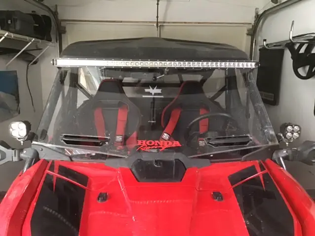

Also have these mounted higher.
44025FEE 0ABF 4562 A78E 49A1191D900F
Also have these mounted higher. View attachment 220730
Dang dude, you’re the guy nobody wants behind them on the trail at night.....🤣🤣🤣🤣
Presumably they are on dedicated switches. I like the top one but I’ve had to slide under so many low hanging branches on the trail That I’m afraid to mount one up there unfortunately and I tried just under the lip, but I’m tall and my visibility out the top of the windshield is already diminished on the Talon compared to the Pioneer.
I also like your low pods out front above the winch. 😎
Haha, it puts out the light for sure. We have some low stuff too, mostly overgrown brush and the paint is starting to wear off on the eleading edges. It is below the lip of the roof so that helps. Yes, separate switches. I also broke apart the wiring harnesses to isolate the relay from the switch. Relay to direct power and switch to key power. This keeps from running the relay amperage through my keyed power fuse on the XTC buss bar
Oh I couldn’t see that yours was under the lip. That’s good protection.
Im doing the same thing with relation to the keyed power, relay and switches.... that seems the best protection.....
