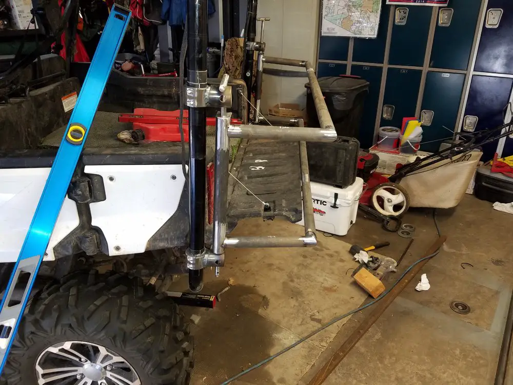

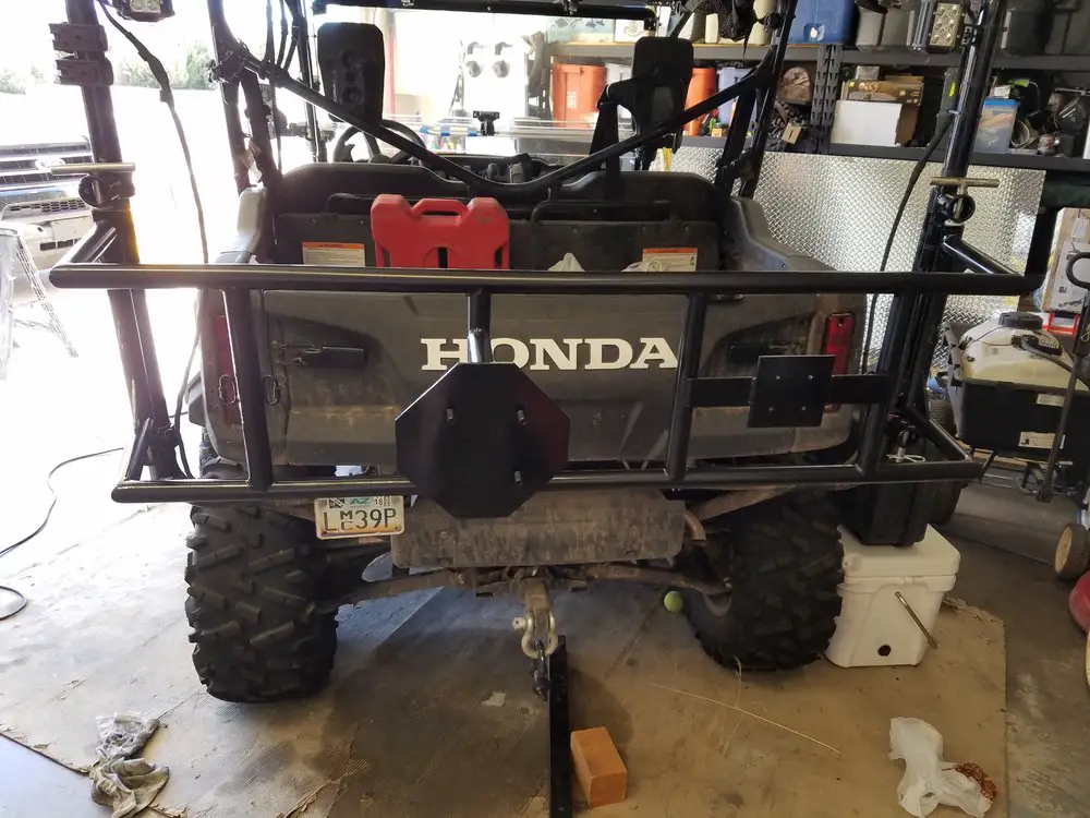

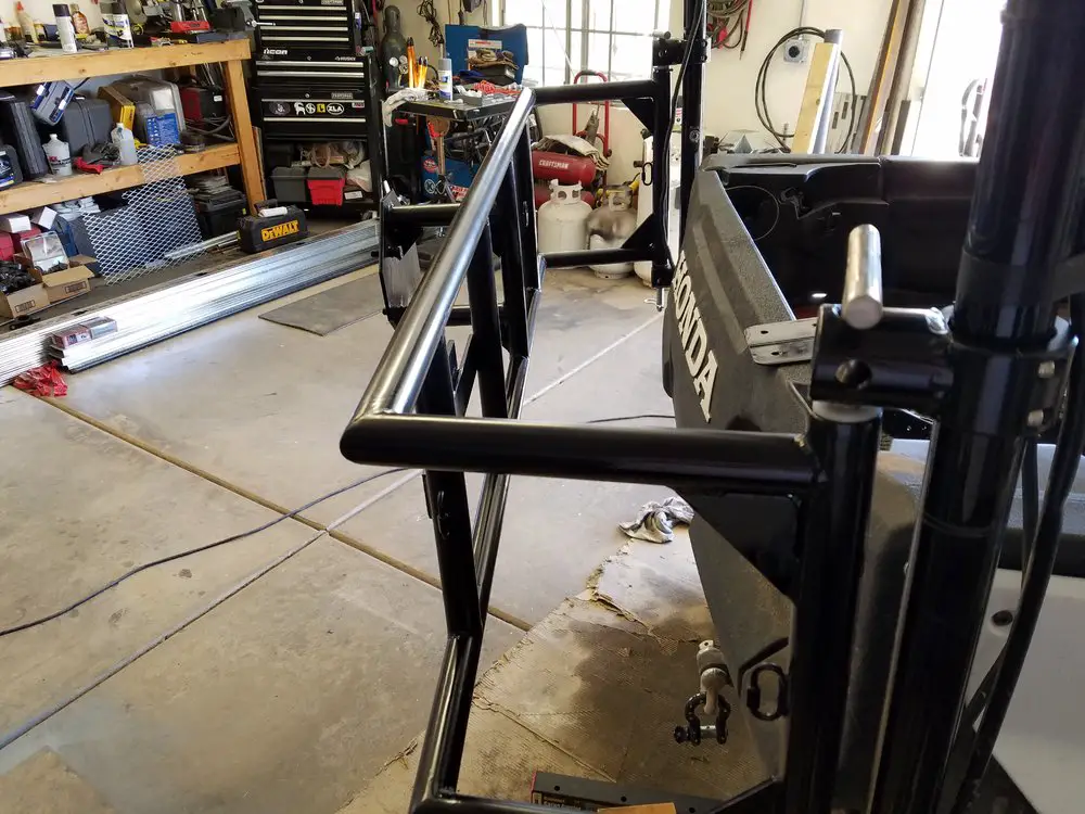

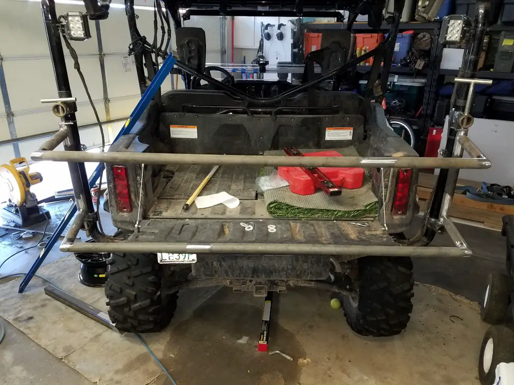

Rear rack mocked up...don't have a tubing bender, so I had to miter my corners...oh well.
20170923 142324
20170923 142331
You can see the clearance off the tailgate. It acts as a bed extender and rear rack.

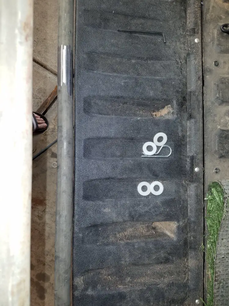

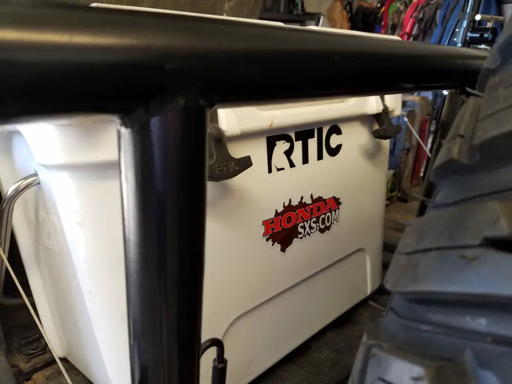

Yeah, I used 1 7/8" metal clamps from ebay. I used a 1/16" rubber strip btwn the ROPS and clamp to make up the difference. I bought the rubber at Ace. It came in a flat sheet, and I cut it to fit. Here is a closeup...

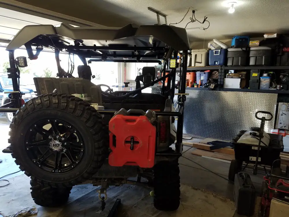

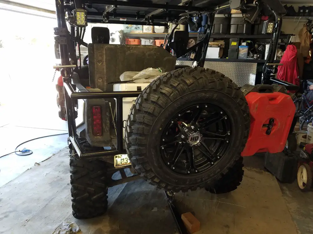

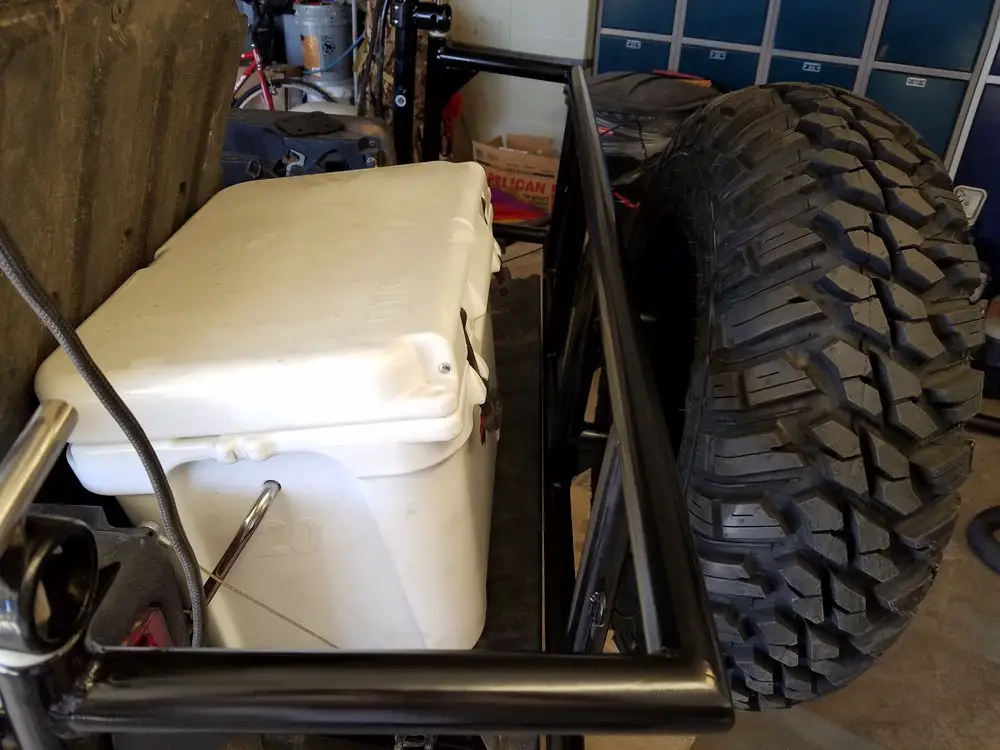

The package at Ace had two different size sheets -- 1/16" and 1/8". I used the 1/8" as a buffer between the spare wheel and the rack, as follows:
20171003 075045
I just drilled the holes for the lug studs and slipped it over them. I dont have to worry abouy rattles now.
