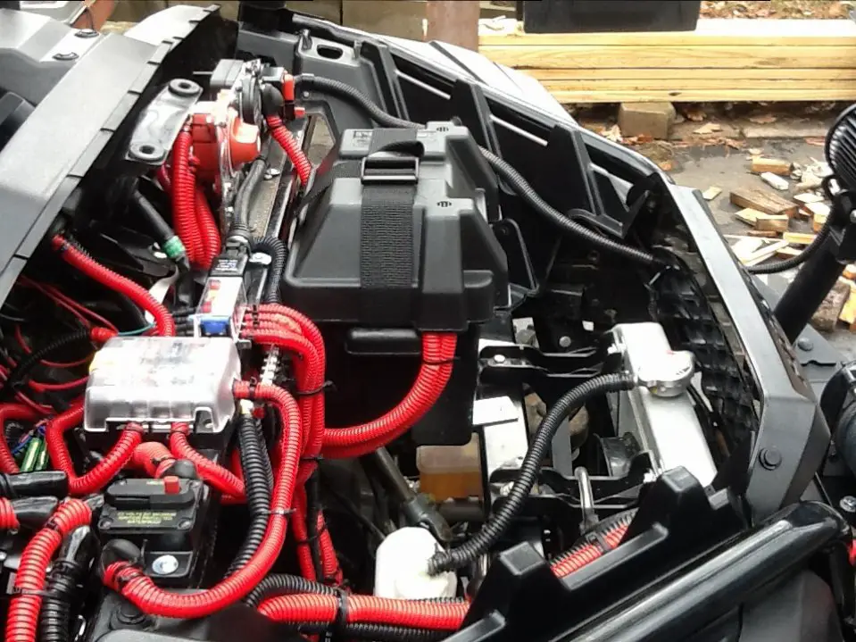

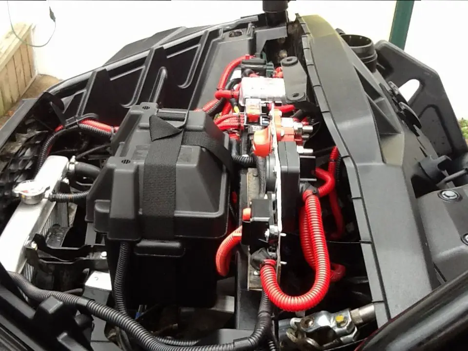

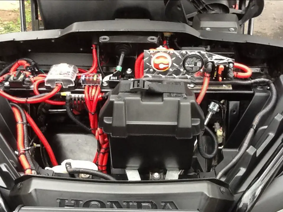

I did that too.
Image Image Image
That looks great! Did you add all of the wire in the red conduit?
Both red and black. You know how naked the P-5's are under the hood before you add anything! Now I have easy access for adding any accessories I wish.

@Montecristo - Is that a 100A breaker I see by the battery disconnect?
Yes, and another infront of the winch solenoid and there's another in the battery box.
