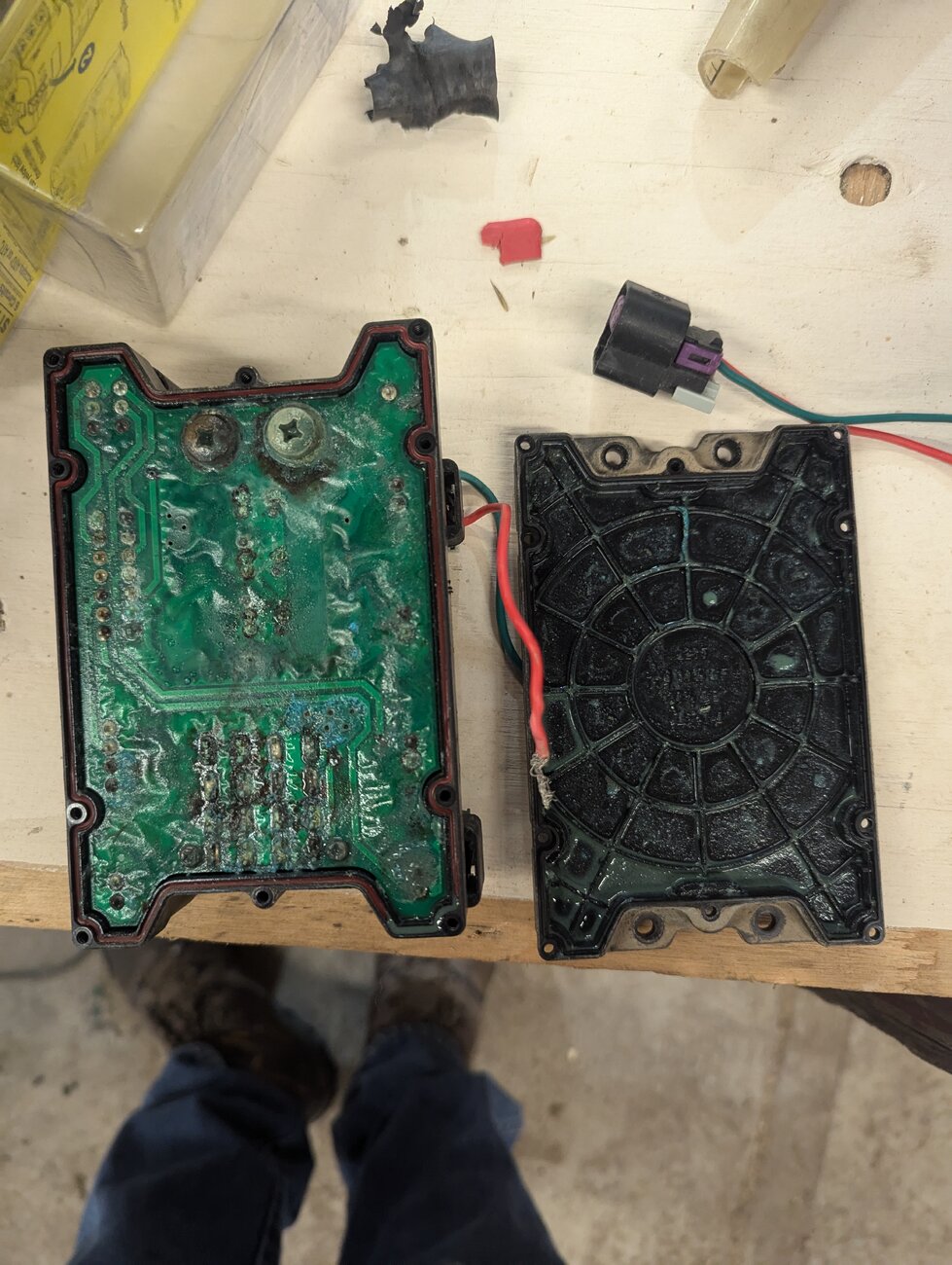

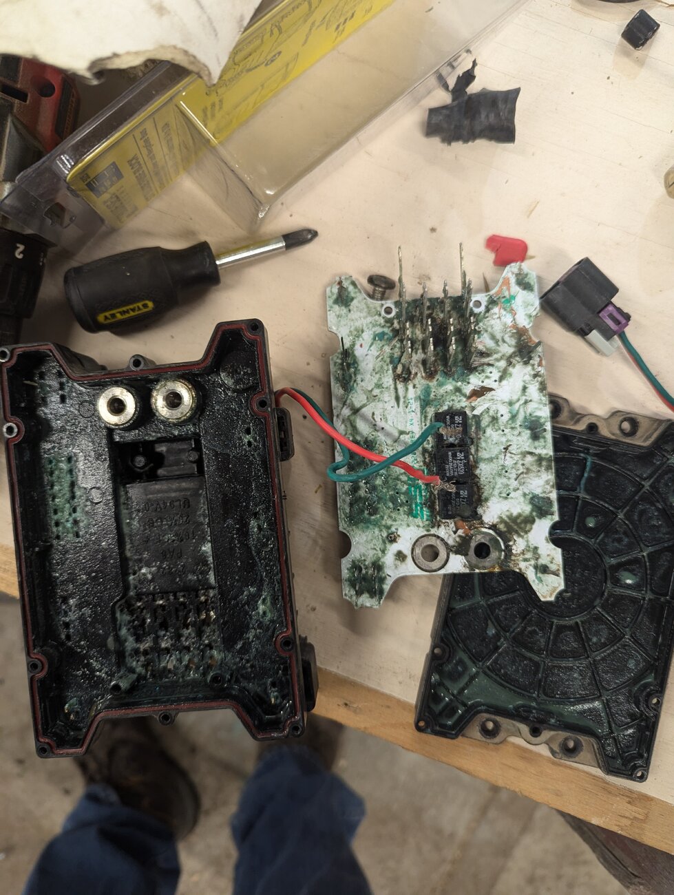

I received a 2022 1000-3 pioneer in June of 2022. The end of June 2024 my OEM fuse panel is trashed. I have never "swamped" my machine. I use it strictly for work. Rain snow and shine. It's shedded every night. I also never washed under the hood compartment. If it needs cleaned there I use air. I have no idea how this much water ended up in a "sealed" component. I've been hunting a reason for a consistently blowing fuse. Finally found it. Pics below show what happens with normal wear and tear.

I had the same issue My dealer replaced mine under warranty without a problem Like you I never swamped it or washed under the hood. No problems with the new one and I have not changed how I use the machine. Were some of the earlier ones faulty?
Mine was missing the pigtail plug for AUX 3&4, if any of the plugs are missing on the top of the fusebox water can enter into the fuse box. A simple drain hole would have avoided the flooding condition you and I both had. For anyone else who has the OEM accessory fuse box I would recommend making sure all pigtail plugs are installed and maybe add a drain hole in the bottom. My replacement fuse box is a year and a half old, my machine always stays outside. I added a drain hole and made sure that all pigtails are installed and have had no issues
